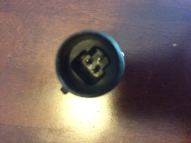

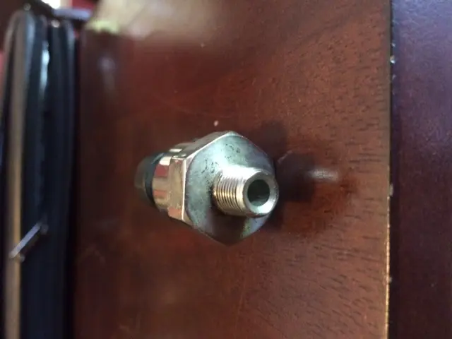

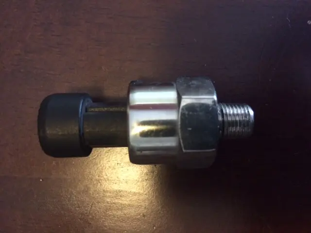

I'm working on a friends 2007 Mustang GT and can't identify an electronic sensor. My friend bought the car used and it has a Paxton SC installed but it is non-cooled. It also was plumbed at one point for NO2. Looks like some of the plumbing is still there. The Stang has Aeroforce gauges installed too.
This is the sensor:
It was screwed in and located in the underside of the air pipe connecting the SC and the throttlebody. It didn't have an electric connector attached. I'm not sure if this is causing a problem because I can't identify it. Can anyone help?

I do not think that this pressure sensor is your problem.
It looks like one that is specifically designed to drive a gauge. It's probably 0-5V output so it could also be used to data log or as a map for a boost controller or something.
p.s. The link is just an example. I do not know if the two switches are the exact same.

Fantastic, as soon as you wrote your answer I googled Aeroforce gauge Boost sensor and I found it. You were spot on too, 0-5Voutput. Thanks
