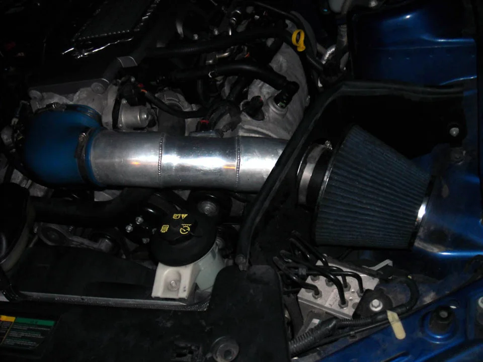

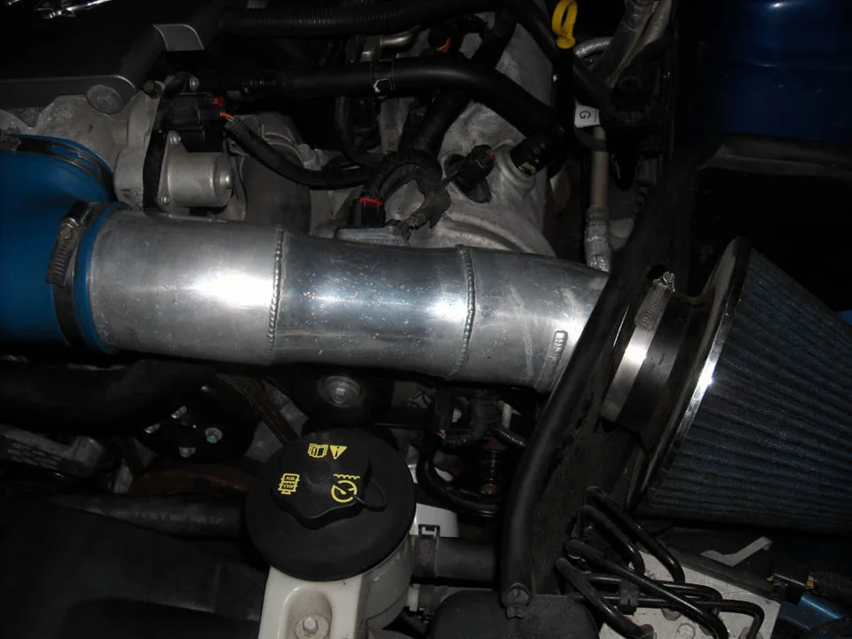

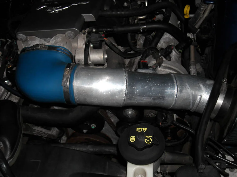

OK, I've been through pages upon pages of CAI's and have utterly no idea what this one is. It was on the car when purchased... yes, I know the filter could use a bath... but thanks for noticing... LOL
Can anyone give any idea what it is??? Thanks in advance...

Well, since I've stumped the pros... what did I win??? LOL

I've never seen a CAI like that before, maybe someone custom made it??

That pretty much HAS to be a home job. What company in their right mind would neck-down a CAI before the throttle body? :shrug:
Makes no sense. Very nice welds though. :)
Speaking of which... :chin Where is your MAF sensor? Is it on the bottom of that necked-down piece?
I was beginning to think that since I couldn't find one remotely close to looking like it... the MAF is the RED thing about midstream on the narrowed portion in the back...
