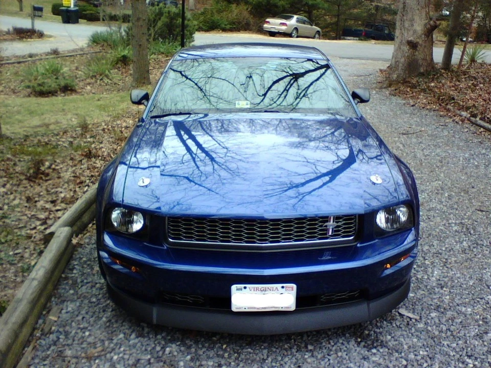

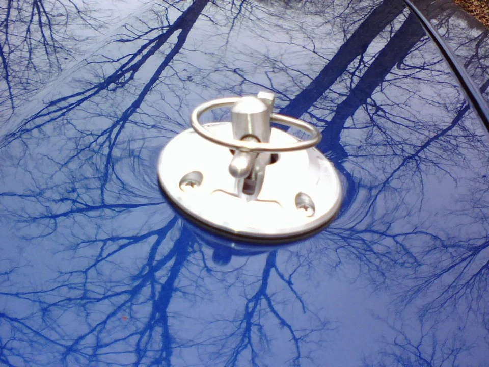

Have you not noticed hood shake? Im sure you have driven faster than 80 mph, and if you havent, you should be ashamed of yourself!! I did mine strictly for the bad hood shake that occured over 100 mph..I would have rather not drilled holes in my roof...heres a couple pics finished..

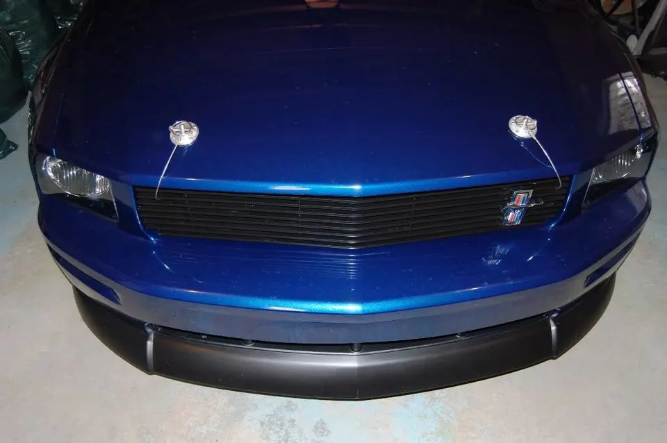

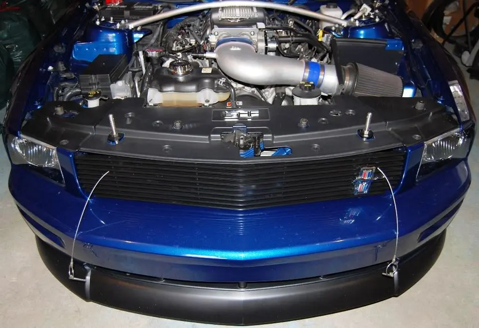

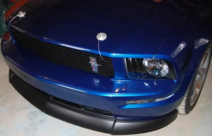

Yes and whatever you do, DO NOT INSTALL THEM ON THE OUTER PART OF YOUR HOOD!!!!!! I messed mine up by doing so:mad: I used the outer most factory hole in the radiator support and it won't let the top plates sit correctly for the pins to sit flat in the recess! Of course this wasn't even possible to tell until I already had holes in my hood! Now my best bet is to ditch all my drag racing upgrade goodies and put it towards a new hood and paint:mad:

I like the location of it now just not the results of the pins/scuff plate. I want to get the Steeda cowl hood. Then I will mount them a lot further in next to the radiator cover, even if it means drilling new holes in the radiator support!
