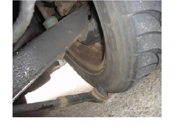

Well, I am driving down the road today and I hear a clunk then dragging noise. I looked under the car and see this piece dragging. Only one wheel turns. Is it the tie rod that has broken or is it the rack n pinion? Any idea what has broken here and what would have caused it.

Your outer tie rod end broke.
Were you getting any noise when you turned the wheel before this happened? sometimes they will make a creaking noise.. others like my car will make no noise at all but loosen up..
What happens is when the tie rod is worn out the ball and socket joint gets looser and looser until the tie rod fails like what happened to yours, your very lucky you did not get into a accident.

Outer tie rod end has come off. I am not sure but it almost looks as if the steering knuckle is damaged as well where the tie rod end attaches.
I do not see any damage to the lower control arm in those pics.

I doubt it. It looks to me that the tie rod end broke and when it did, it slammed downward and hit the brake dust shield. Basically you could bend the dust shield back out unless it's fubar and it doesn't look too bad. Just re-paint it after you bend it.
You will need to definitely get a new tie rod end (get one with a grease fitting) .. they are cheap.
You may need to replace the inner tie rod but I'd start by just getting a new tie rod end and if it acts up, get a inner tie rod. And definitely get it alligned after you replace the stuff ... tie rods control your toe (if you did not know) so your alignment is gonna be jacked up.
You're lucky! No steering usually doesn't yield the best results. :(
Holy $hit man!!! You are damn lucky you didnt get in an accident, you must have been a saint or something in the last life... +1 for the outer tie rod end for sure, based upon all the grease and dirt under your car it looks like a high mileage vehicle. If I were in your shoes I would go ahead and replace all the ball joints/tie rod ends just to be on the safe side, and since you are going to be right there and will definately require an alignment after.
As far as the picture with the arrow, thats your backing plate/shroud and you will be fine with that just how it is so long as it isnt scraping on anything.

Guys... In the scond pic with the arrow. What is the piece of metal that looks like it has a hole.
thats the brake dust sheild... just bend it back into shape, I bend those things on purpose sometimes for better access while working.. they bend right back..

you'll need the knuckle, outer tierod end, the shield,
He does not need a knuckle or brake sheild.. he only needs a tie rod end and maybe a inner tie rod and a alignment.
you can even see much of the steering knuckle in those pics. The brake sheild ( the part the arrow is pointing too) can be bent back into place.
