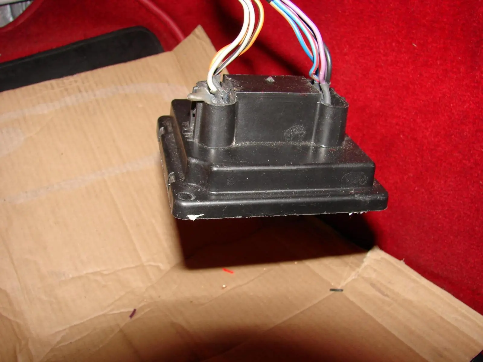

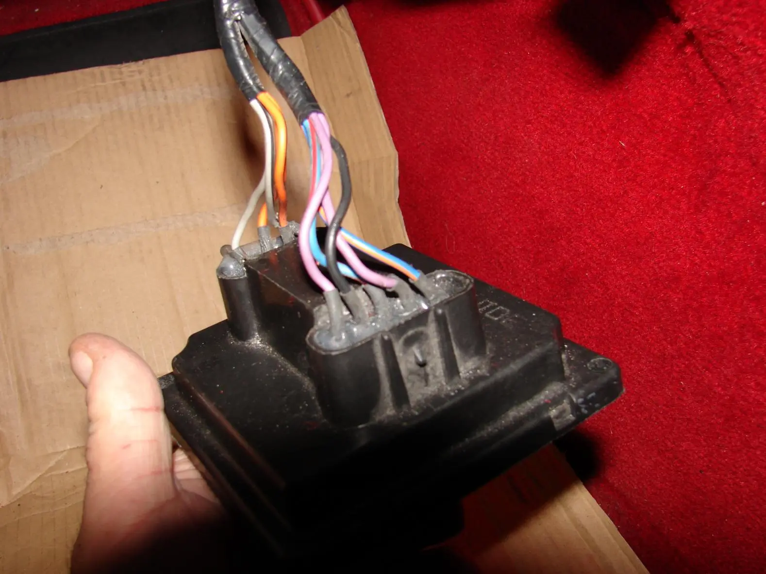

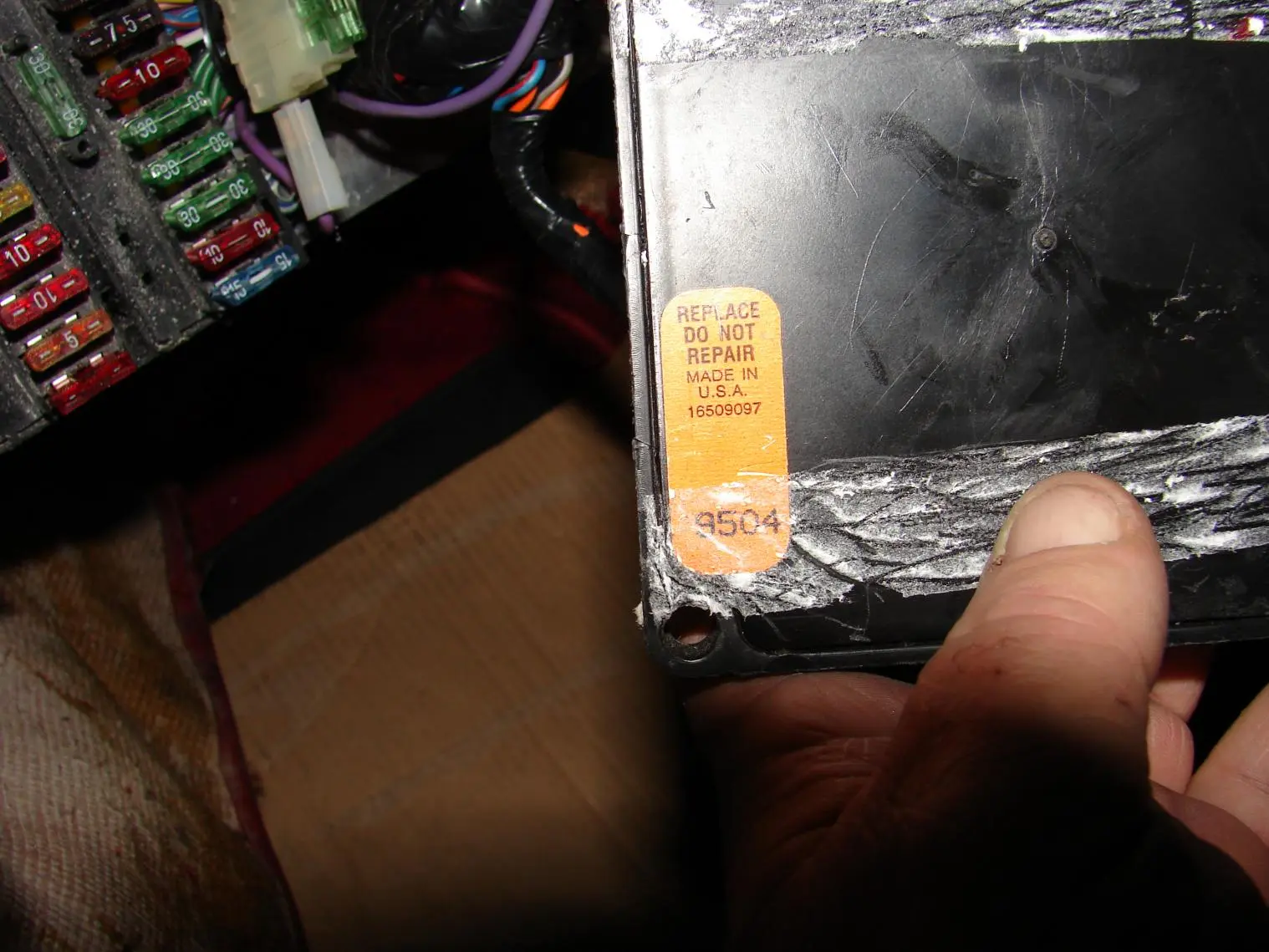

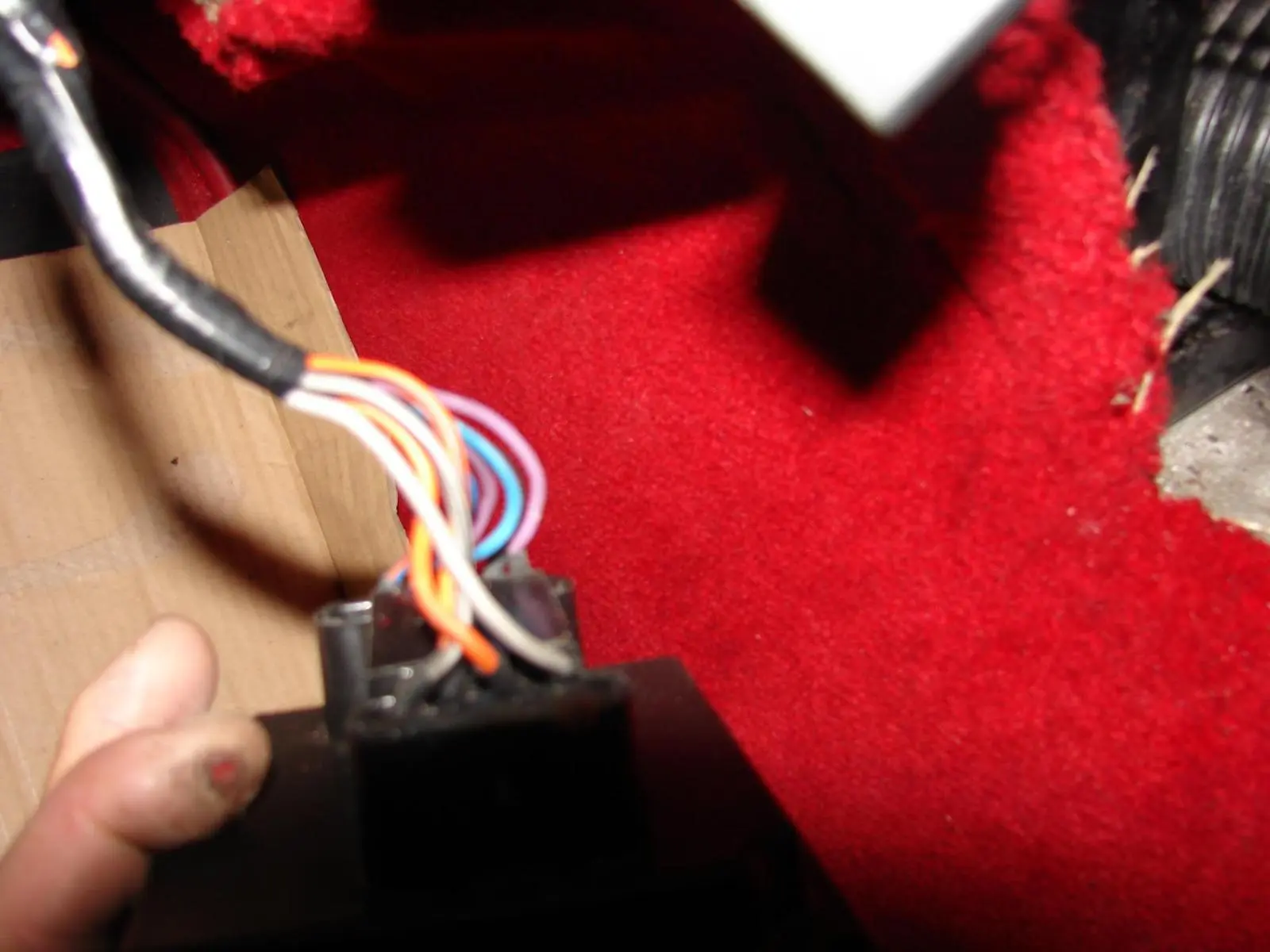

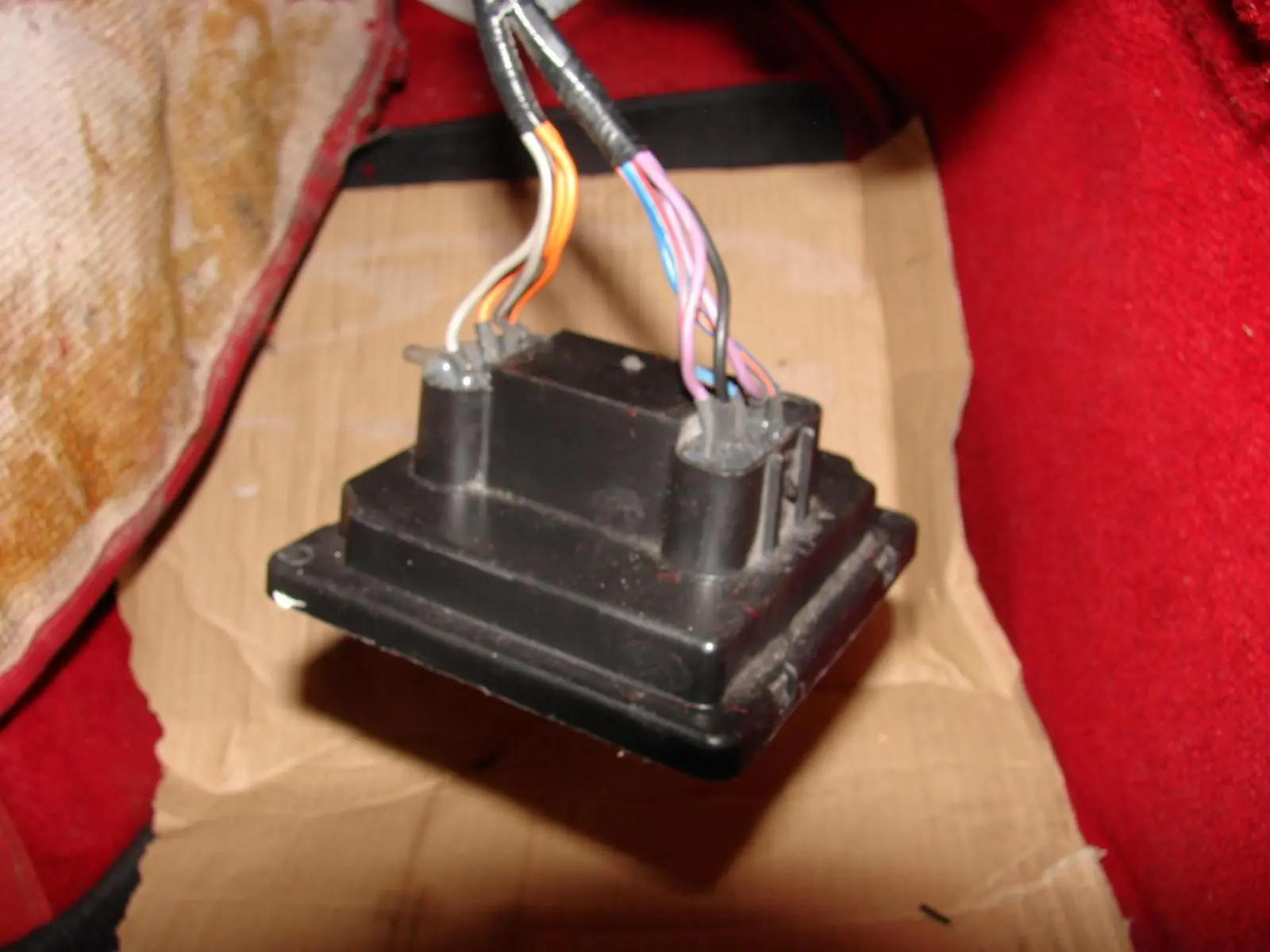

Hi Guys,
is there anyone please who know what this electrical box is up under my dash
and any information on the wiring would be a great help
many thanks for any assistance

Sorry Guys but not sure the model and year will help, but here goes
Spectre R42, 4.6 cobra Quad cam, Audi 6 speed Transaxle, all ford (mustang)electrics as far as I can tell, car left the factory in 1996
so hoping someone might recognise the box in the pictures, I'm working blind on these electrics as I cant find a wiring diagram that matches any of the wiring colours at all
Thanks for any help on this one
That's a headlight actuator module. Probably from a GM. It looks like someone clipped the connectors off of the harness and hot glued the wires directly to the pins.
EDIT: Looks like you can find one in a 1990 Buick Reatta.
