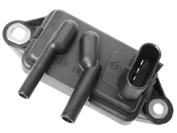

This is what the sensor looks like!
This is what the sensor looks like. Driver side rear of engine near the firewall. Good luck, Tommy.

Wow this was totally unplugged I guess when I did my head/intake/cam swap this was missed. My girlfriends dad and son helped me with the swap and they just started tearing stuff apart, where I was tagging everything. They had the drivers side Could I have hurt anything by running without the sensor for about five months? It seems like the sound started after I had my bassani exhaust installed couple weeks ago, and I checked for exhaust leaks it's all good tho. My plugs were whiteish and had deposits and they were installed 5 months ago. I also was backfiring one day but only did it twice and have not done it since I stopped driving it. Does this mean I'm running lean?
