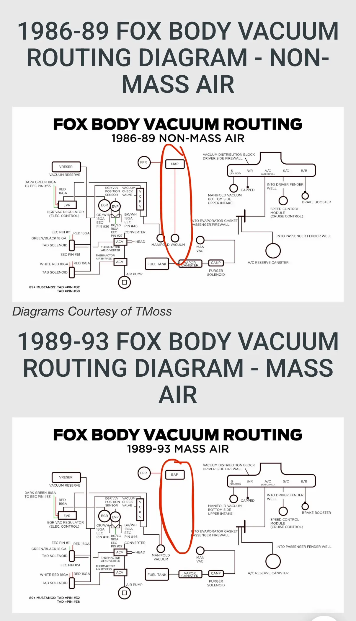

91AOD5.0LX I have a slight sag in my rear 5 Year Member Feb 20, 2021 1,096 1,050 133 Lake George NY Aug 4, 2026 #3 Aug 4, 2026 #3 86-88 cars (MAP) sensor does have a vacuum line. 89-93 cars (BAP) sensor does not have a vacuum line. (Courtesy TMoss / LMR) Last edited: Aug 4, 2026
AeroCoupe lube between the nut and the face. I know my lubes Founding Member Oct 28, 2001 6,238 4,331 183 Claremore, OK Aug 4, 2026 #4 Aug 4, 2026 #4 With the exception of the 88 mass air California cars. They do not have a vacuum line on the MAP sensor.
