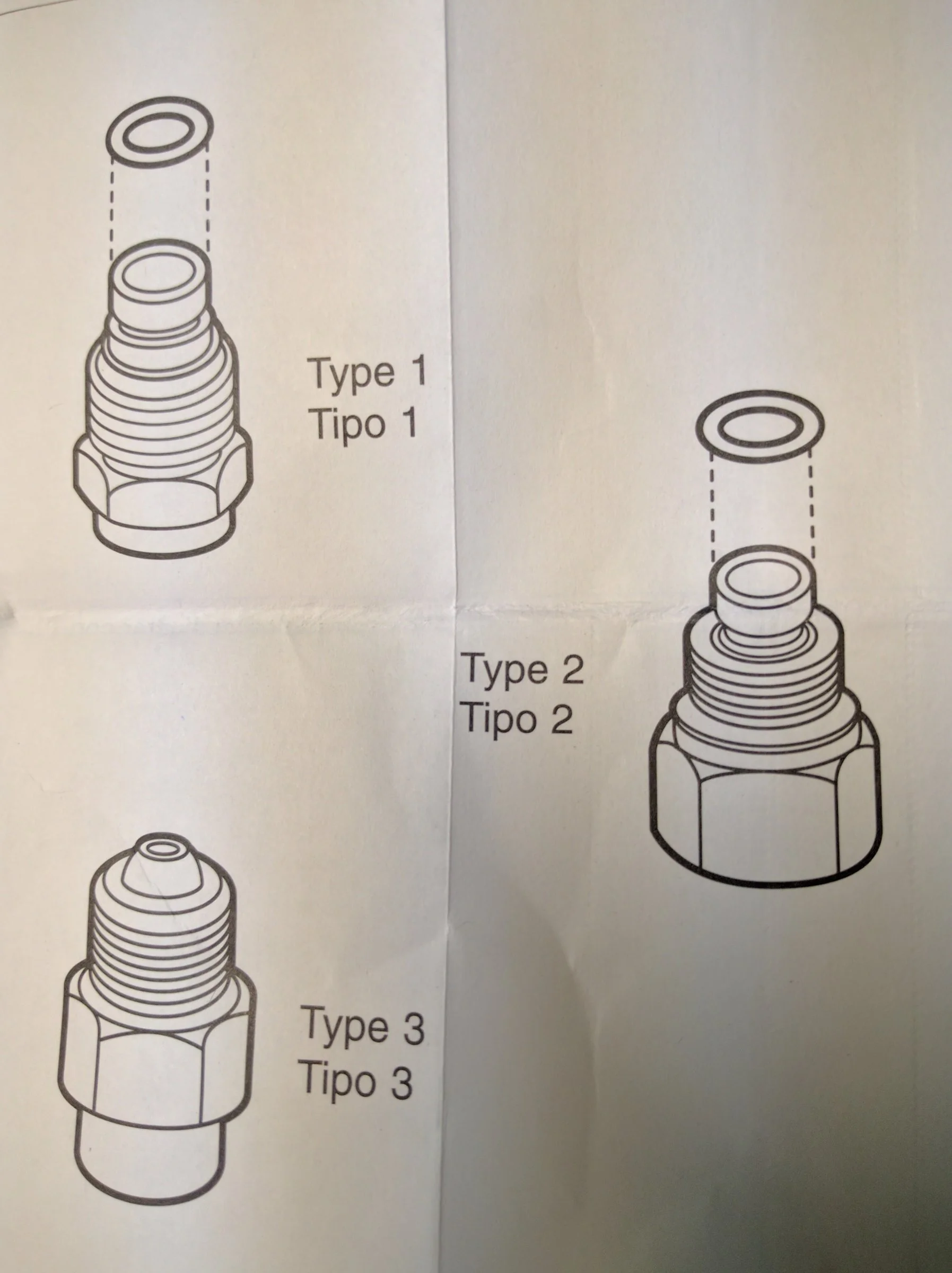

In case it might help anyone in the future here's a pic showing the different fitting types, from an info paper that was included with my new (1990 version) hose:

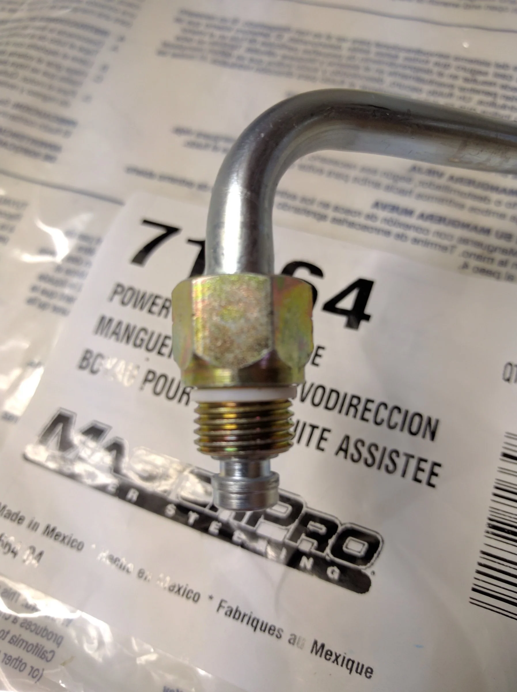

Rack side with fitting pushed back to expose o-ring:

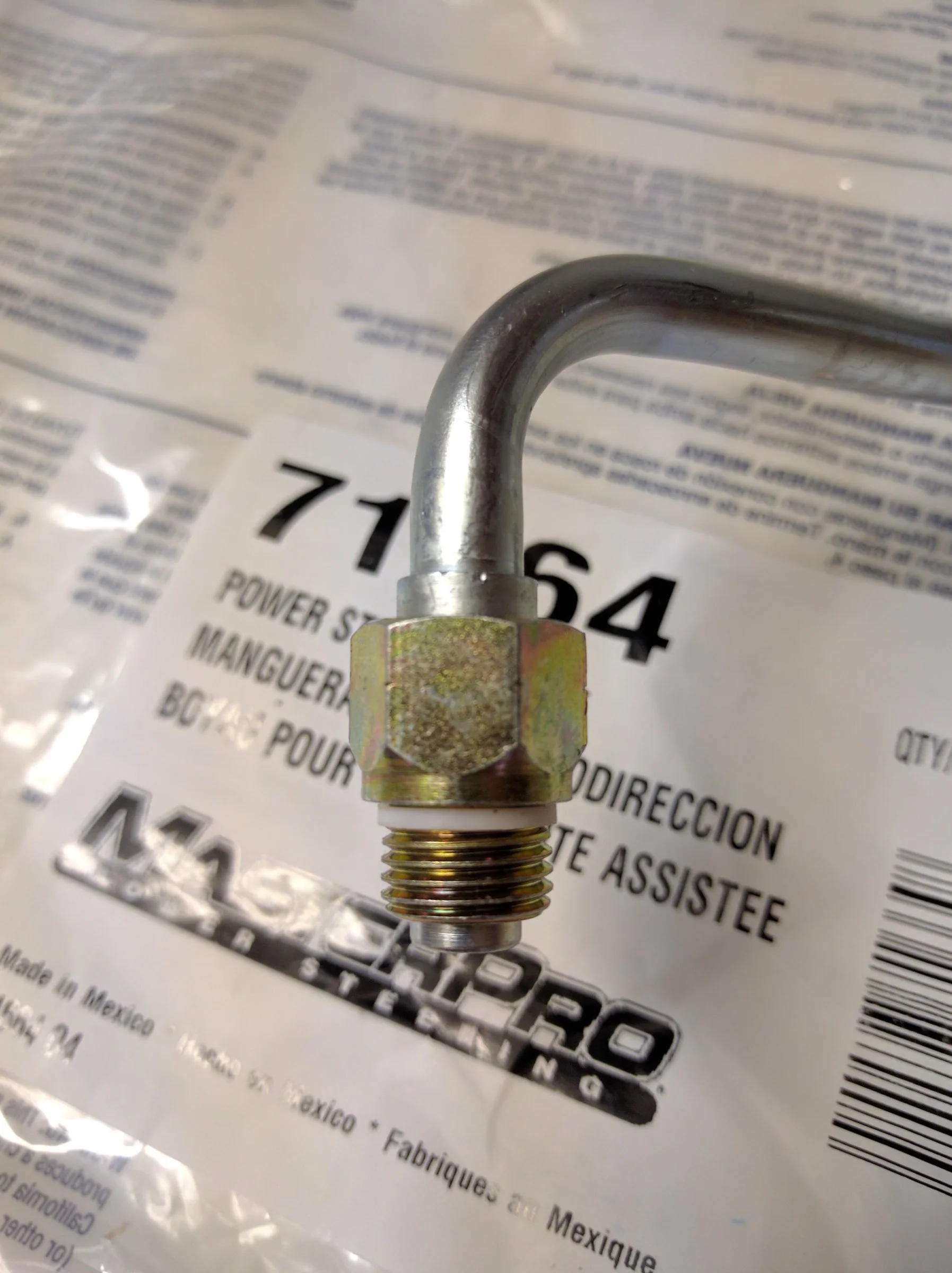

Rack side with fitting pushed forward:

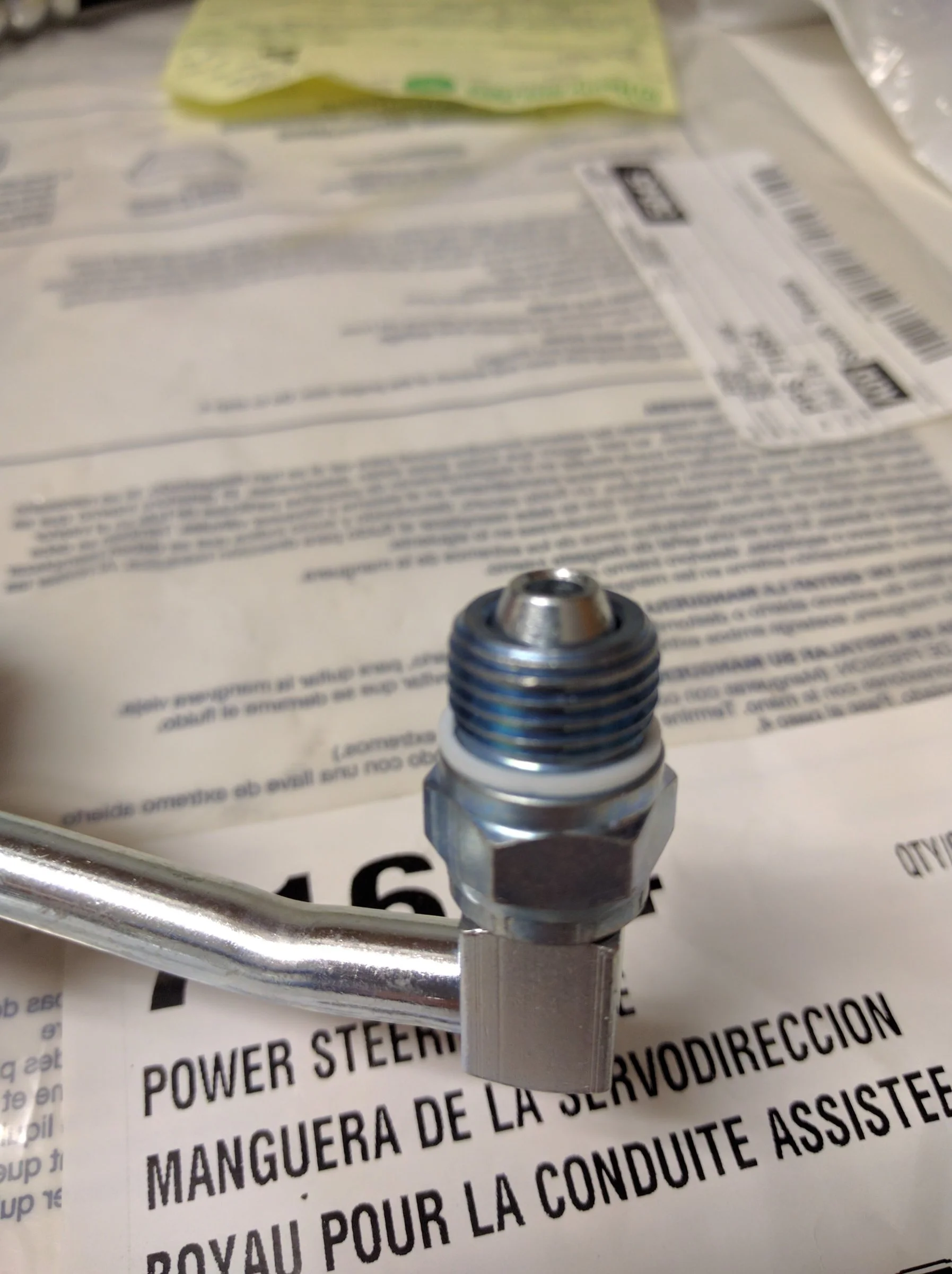

Hey guys, just wanted to give a quick update on the PS leak. I replaced the leaky pressure hose with the "1990" style hose I got from O'Reilly and it hasn't leaked since!
The install was much easier than the "91-93" style hose too, because the Type II fitting on the rack side allows it to spin much more freely and allow you to get the threads started. The Type III fitting on the 91-93 style was REALLY hard to spin by hand and really tough to get started on the rack side without a wrench.
It was also easier to install on the pump side because the fitting had a different style elbow that gave more clearance between it and the battery tray. For the Type III style I ended up removing the battery tray to get the pump side connected.
