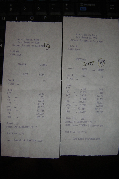

I have a 08 Vert with CAI and dyno tune with 4.10s. My best time for 60ft was 1.94 on stock 18in wheels/tires. Quickest down the 1/4 mile was 13.21sec. Never ran her on the track without the 4.10s so I can't say how much it helped. But the dyno tune definitely helped a bunch.
So kooldawg, does this mean I can take you on at the next track day? :Track: But you'll have to leave all of your seats in the car.

Sure! That will be a blast! The first several passes of the day, I always leave the seats in. If the times look good after that, then I take the weight out and run this...
That day, my full interior passes were low 13.2s and some 13.1s. Dropping the extra 70 or so lbs in seats dropped me in the 12s
