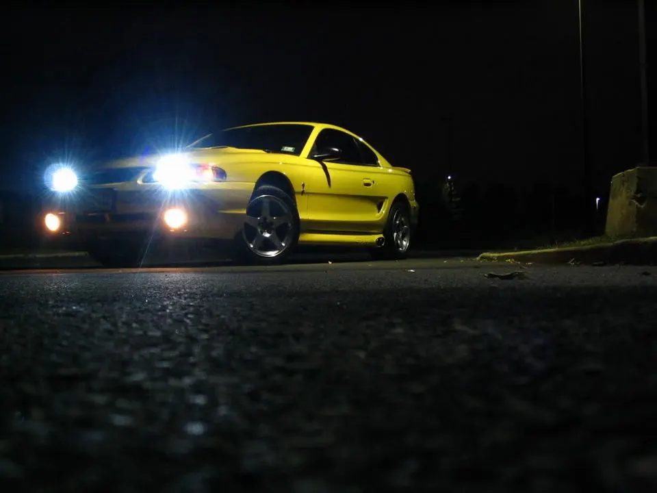

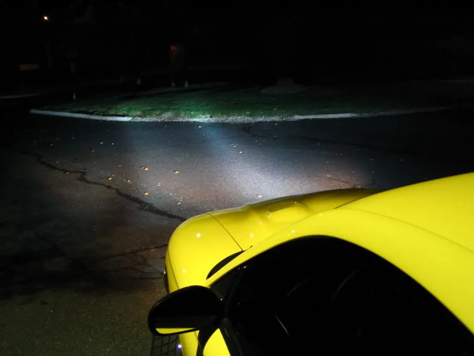

Tangent: If you guys don't mind, can you PM me (or post on here if Adam doesn't mind) what headlight and fog light (if applicable) housings you're using? I've tinkered with HIDs in the fog light housings and I think I'd melt those in about two minutes. I'm curious what projector headlight housings you're liking too. Thanks.

My favorite set up is the one chris has on his cobra. hes using the 2 piece projectors with HID's
They seemed to direct the light really well. Since i have a bixenon kit i was stuck with a stock style housing with one bulb... not the seperate high and low.

Thanks for the info and pics of Chris' ride. I'll read some old threads to see which housings (model number, etc) are good ones. I'd like to do it if it can be done relatively cheaply (for housings) and without blinding people. Thanks again.
