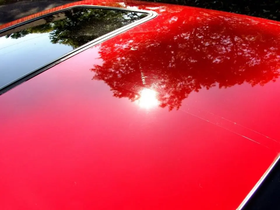

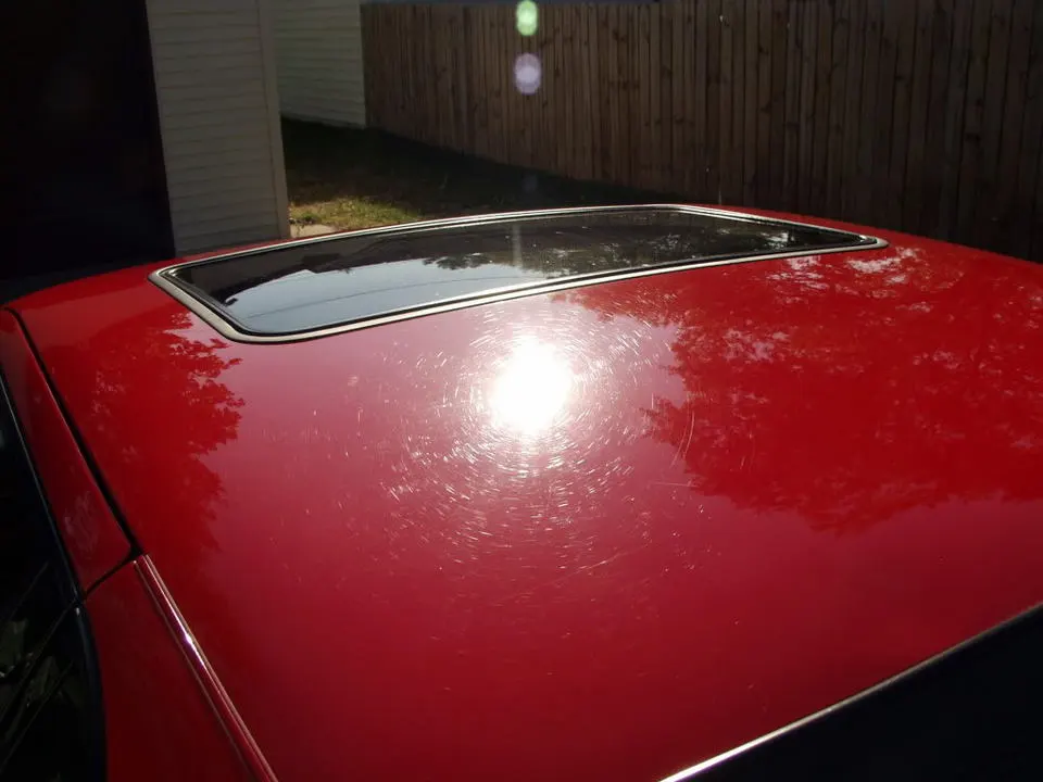

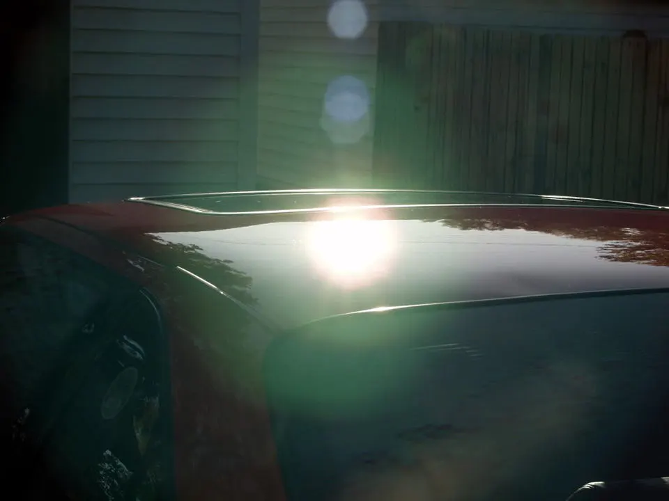

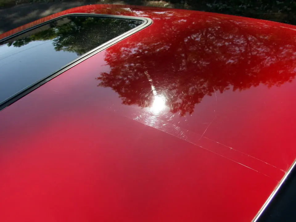

Before shot of roof on my Pontiac (first car I ever polished):

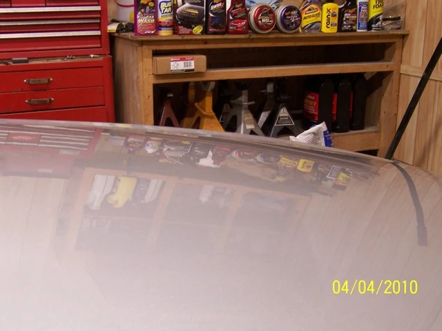

Here's a couple 50/50 shots of the roof:
After shot:

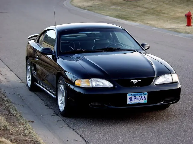

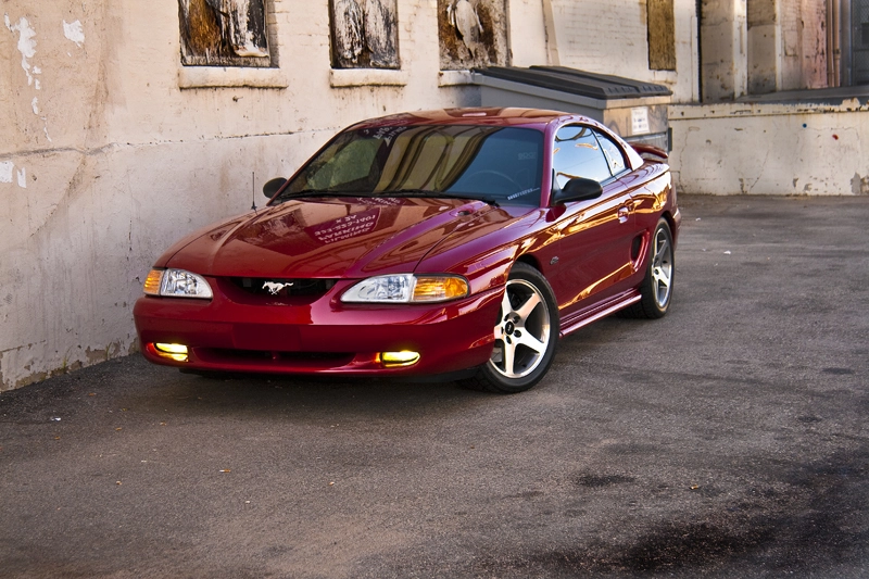

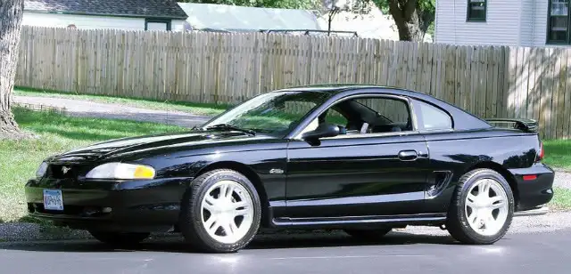

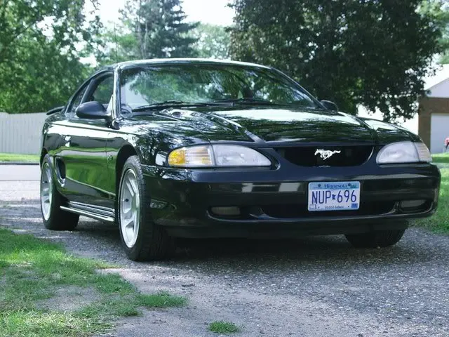

When I detailed my Mustang, I didn't take any before shots but here are the afters:

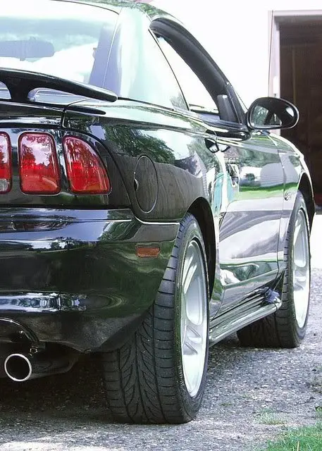

Here's a couple good reflection shots:
The following pic was actually taken about 3 months after I polished the paint, and I had just polished the headlights.

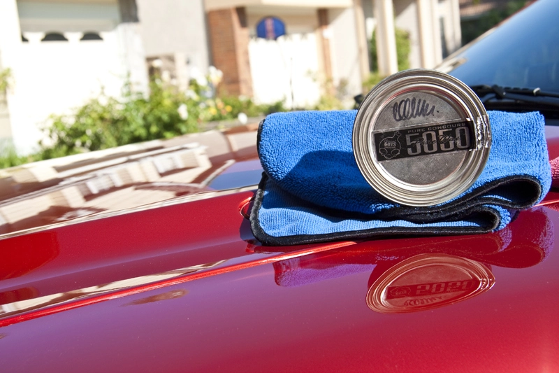

As Far as the Wax Goes, I am still a Sucker for CG WetMirrorFinish+Jetseal109+50/50 Concours.... Makes metallic paint drip wet.
