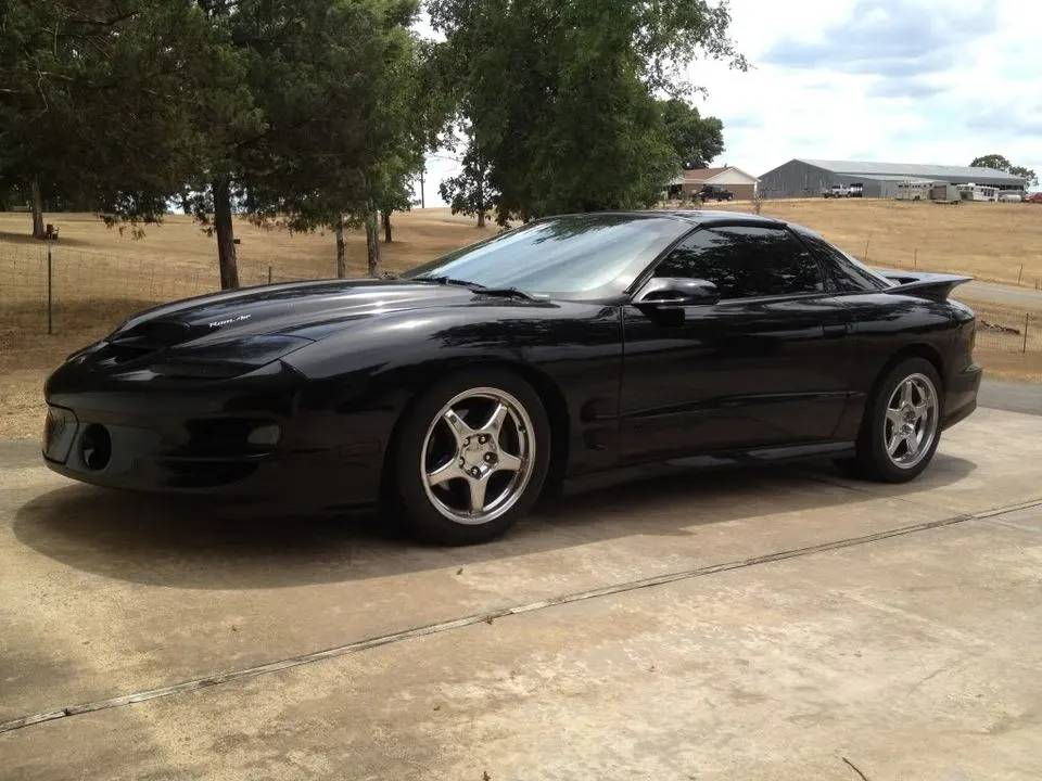

It has a comp cams .588/.588 lift, 228/228 duration, 114 LSA cam, stainless long tube's, 3" X pipe, 3" Spintech super prostreets, LS6 intake, G2 lid, 3.73 gears, Short throw, LS7 clutch, and it's been lowered in the front.
I love it. It's a lot different than my black car for sure. It's a turd down low, but once it hits about 4,000 rpm...it's pulling hard. It's pulls harder up top than my black car did on nitrous. It will be pretty hard to get me back into a mustang to be honest.

Thanks for the compliments, I am loving the car. Yeah it still has the stock rear in it for now. I am going to order a 9" for it at the end of July. I have a set of BMR double adjustable lower control arms on their way, along with a few more little things. I'm not the biggest fan on this cam because of how lazy it is down low, but I'm hoping a set of 4.10's or 4.30's in that 9" will cure that problem for now.
I actually sold all my Modular stuff today. So I am looking to get an LS2 block and build a 408 stroker with some trickflows and put a procharger on it.
I put it on the rollers today to get it dyno tuned. It's down pretty good on power for some reason, I'm hoping atleast a little of it is due to the fact that it was over 100 degree's in the shop and I had been driving the car all day long. It only made 366/349, but the car also does have 160,000 miles on it, so I'm sure it's a little tired.
I'm hoping to get it to the track after I get the lower control arms on it (it's wheels hopping bad when I shift it hard) and the other stuff I ordered.
