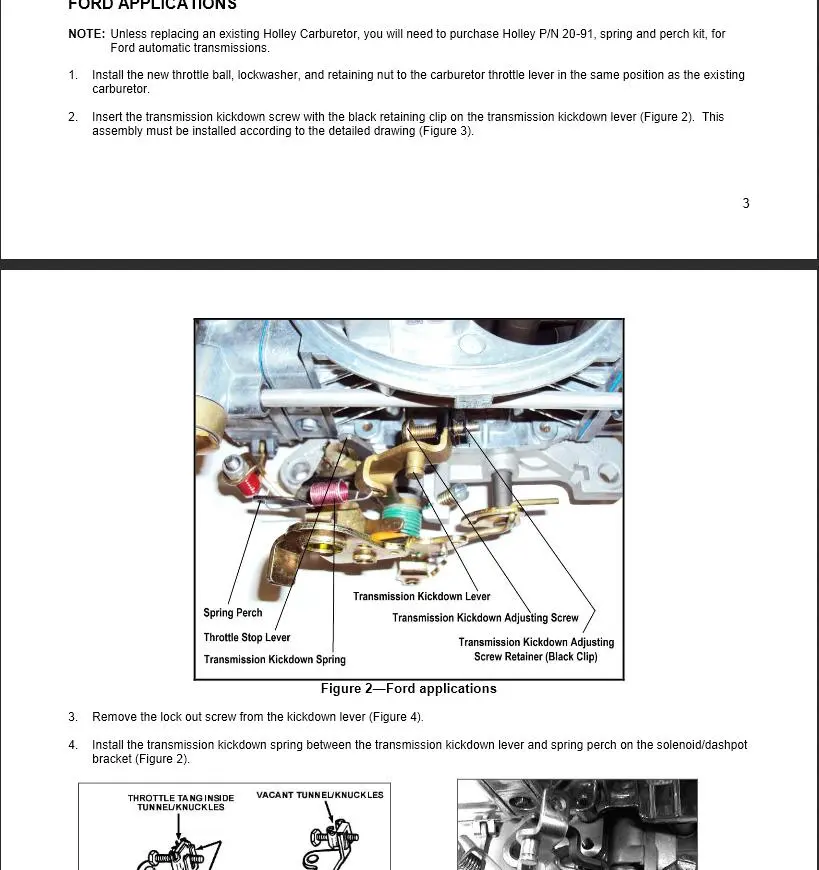

Anyone knows WHY it does not work with AOD?
The carb itself seems to feet my needs, but I have AOD.....
Per the instructions for the carb:
I think that means that it can be used if that part is purchased and installed. Maybe @horse sence can confirm or deny.
Thanks guys, great. Strange how the marketing people at Holly almost pushed me away by the "does Not Work With A.o.d. Transmissions" statement.
Should have said" For use With AOD you need part XYZ"......
