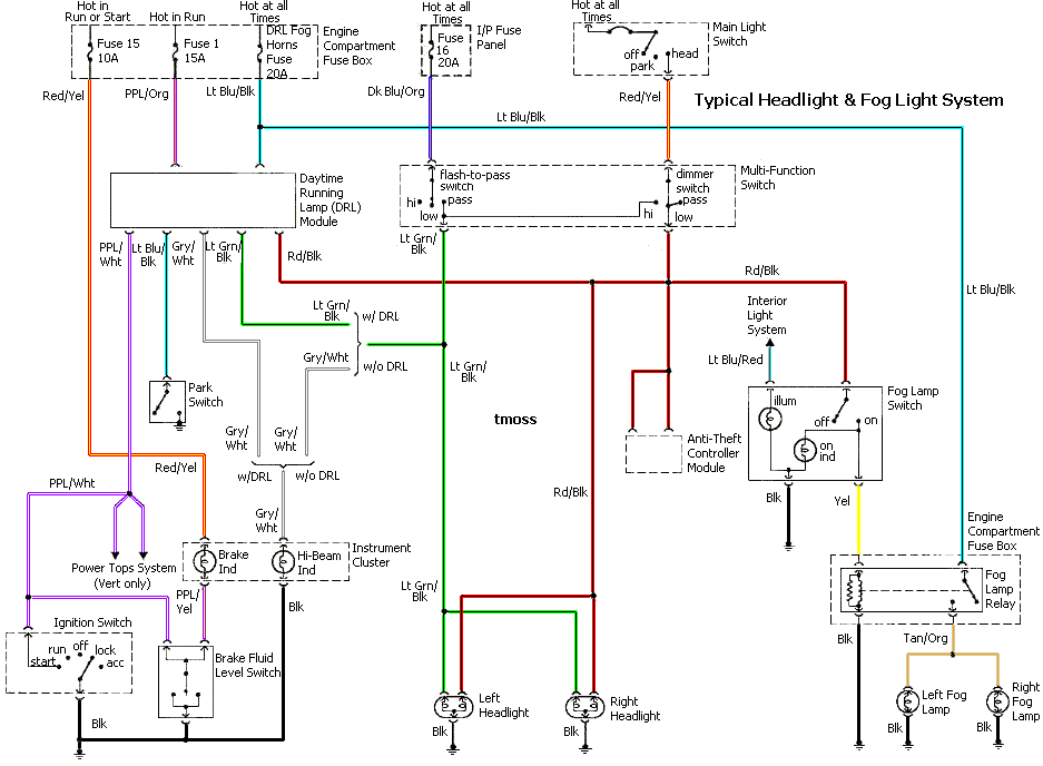

honestly the light doesnt bother me...the highs not working does.
I did find a wiring diagram for a fox (9004) and a (9007) set up and didn't see a difference
9004...
9007...
