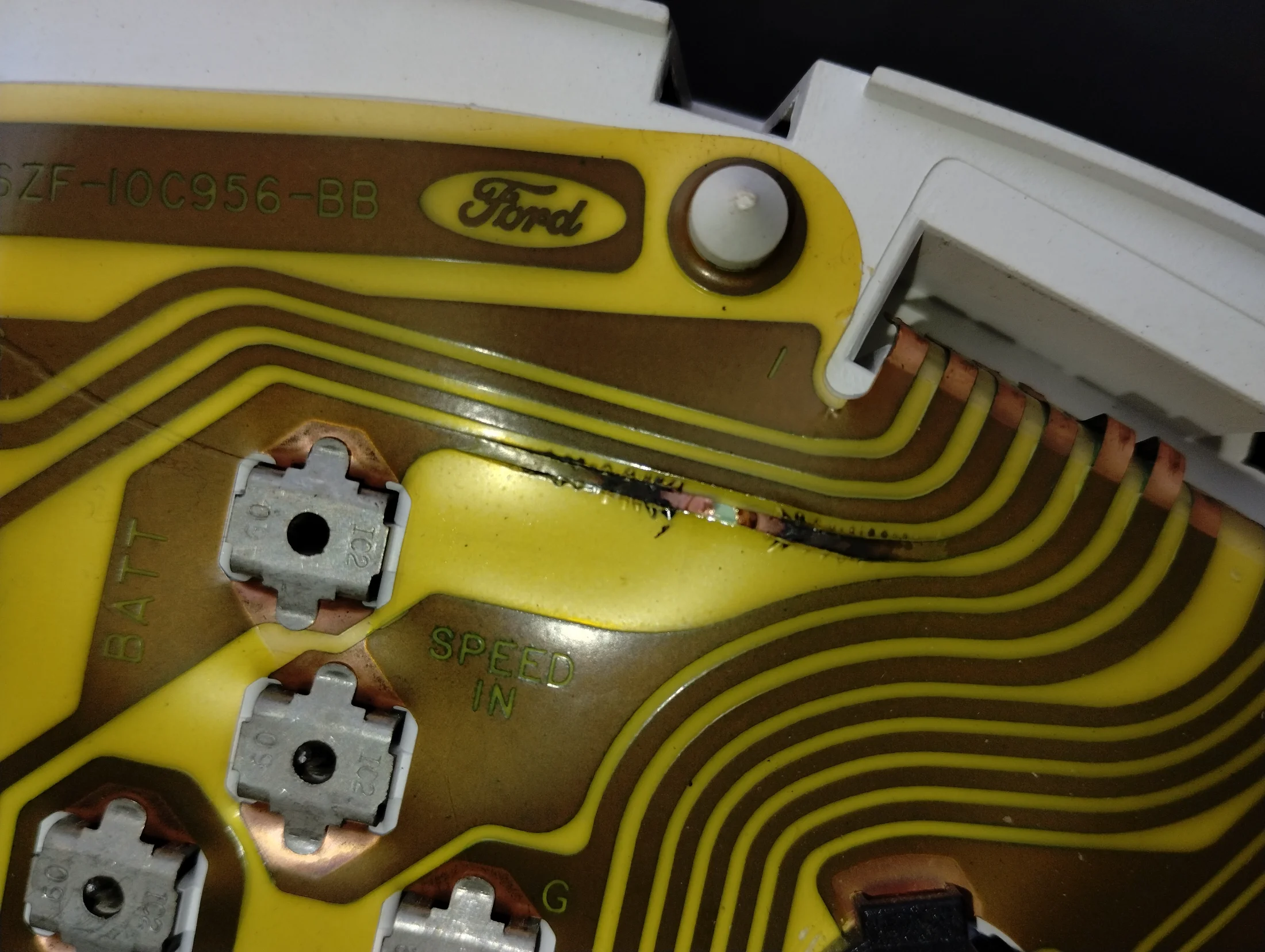

I took a test light to all the fuses under the dash and they were all working fine. So, I pulled my cluster and noticed one of the copper bands on the back was burnt(see photo) I also noticed a strange white powder behind where the cluster sits in the dash.

I would figure out what exactly that burnt trace goes to and start working your way back with a multimeter checking continuity. If you had enough of a surge to blow that trace out like that than it could very well have caused another issue along the way.

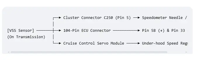

That burnt circuit is the SPEED IN circuit. which tells me a VSS wire got pinched/grounded..
You could have issues that extends into the cruise control circuit/ECU.......
