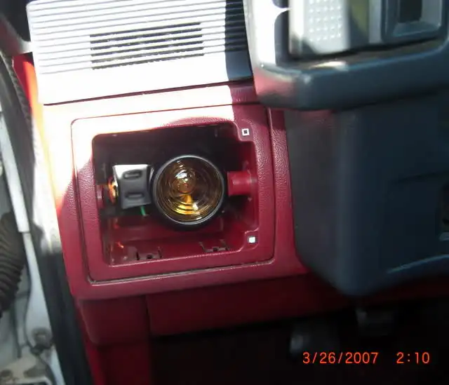

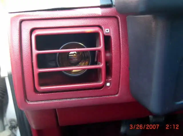

Raptor shift light in the drivers side vent, since you have the gauge cage in the center one. I'll see if I can find the picture I saw of that setup.
EDIT:
Here it is.
EDIT:
Here it is.
Great idea! I am thinking about going that route.

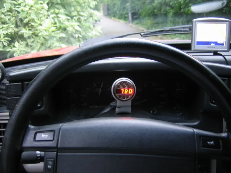

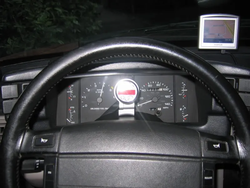

I have the same one - level 2 version - and love it too. I mounted mine on the steering column cover so I could easily watch the revs - the stock tach is stuck on approx 4000 rpms..
Crap pics but you get an idea:
