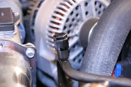

The High Pressure A/C Line Valve leaks in my 95 Mustang GT. I wanted to know if the schrader valve could be replaced or will I need to replace the entire hose assembly. See attachment for illustration.
Thanks in advance for your help.

You can replace just the valve. Here's the info you need:
Clicky
Let me know if you find a good, cheap dealer source for the valve(s) (if replacing one, I'd do both).
Thanks for the info HISSIN50. I purchased the part from Oreilly Auto Parts and installed this morning. It only cost $4.49 which is a huge savings compared to the whole assembly that cost over $200.00.
