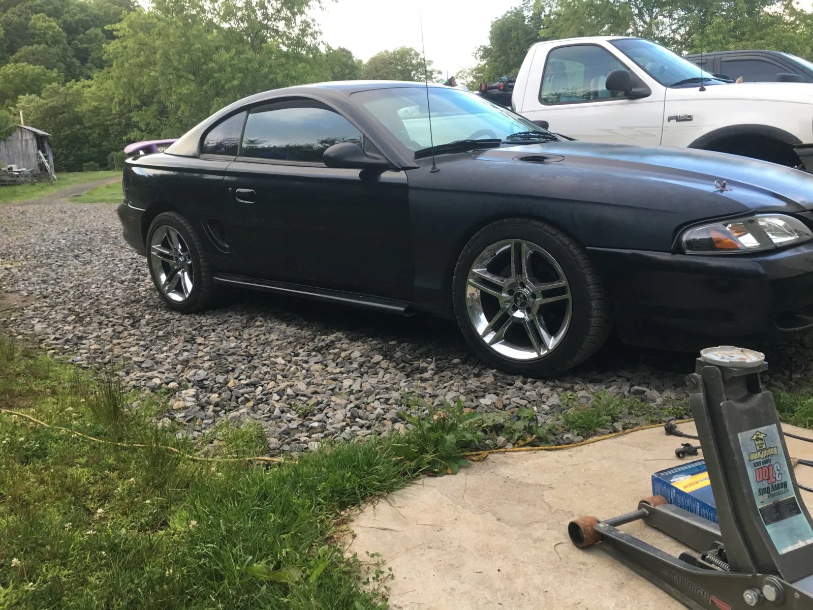

Problem has been solved. I’ve been pretty busy so the car had been sitting for a week or so and while it was sitting I had put in the engine coolant sensor but didn’t have time to take it out. Yesterday I finally got to take it out and drove less than a mile and turned around and came back as it wasn’t running as it should. While stilling running I opened the hood to see if anything was out of the ordinary. Every time I touched the intake tubing and that particular area I got zapped. I had also picked up some new Beldin plug wires when I got the sensor. Swapped wires and noticed a difference immediately upon start up. Engine started faster, engine response is faster, no stumbles at any engine speed under load. I had planned on changing the wires initially during the engine swap but winter time is slow times for me and extra money wasn’t available. Now that the car runs smooth I can move on the the next item of having the 3.73 gear set installed and finish the body pieces that need to be replaced so I can get the car painted back to the original black and I’ll be happy
