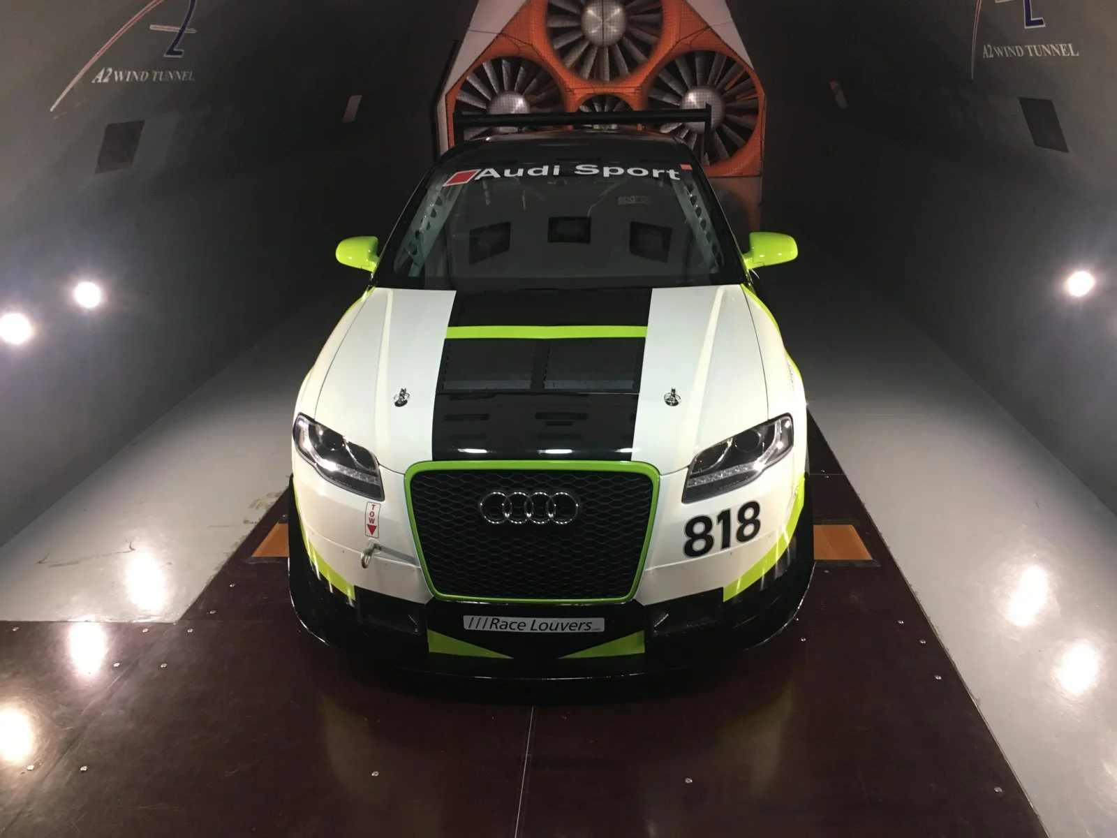

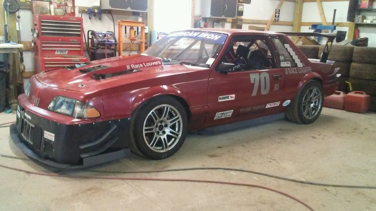

So I got these hood extractors installed on my fox the other day and wanted to share some wind tunnel data with the community. Interesting to see most hood vents do provide some additional cooling and actual front downforce. Will be seeing how these work on my fox in a few weeks.
So I will be posting some detailed results on the Race Louvers facebook page tomorow, but today in light rain we ran the car in qualifying with race louvers, the front grill restricted and 3 degrees of additional wing to balance the car and then later in the race in the same light rain without race louvers, the larger usual grill opening and 3 degrees less wing our best lap was about 7 tenths of a second slower.
