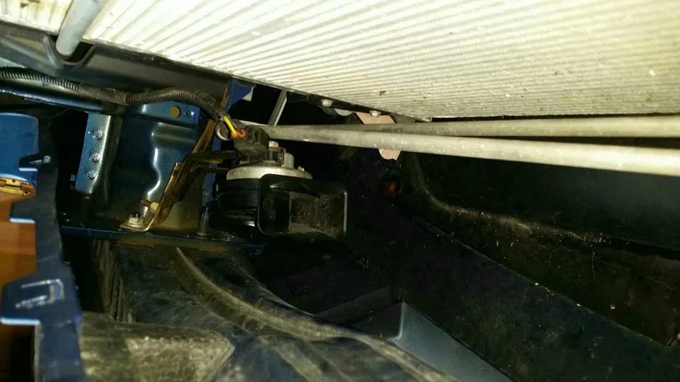

Wish I would have taken pics as I was doing this. But this is an easy fix to move the location of the stock horns to clear the eleanor grille a little better.
This would the the finished product

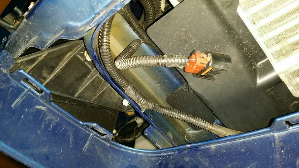

This is the re routing of the horn wire bundled with the passenger fog light.

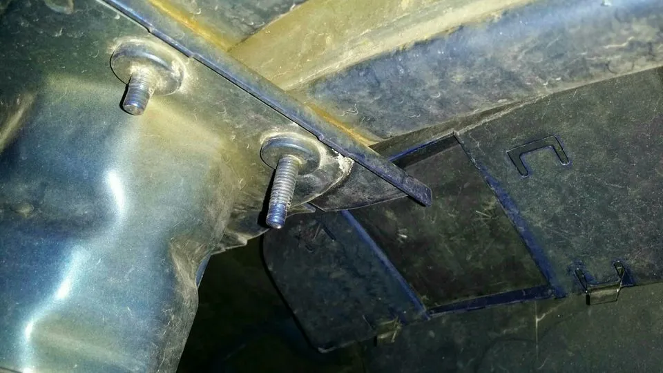

The horn is located behind lower fake portion of the facia insert of the bumper.
I used a little piece of metal and 90'd it and attached it to the bumper support bolt.
