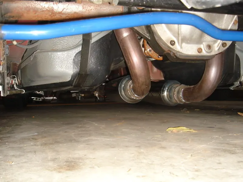

I welded in a set of Kooks resonators before the axle with straight pipes back...also I am running Kooks Long Tube headers with their H and racing cats...sounds great.

man, those babies are hangin low---any trouble? What did you use for the tips? any pics? Thanks!
