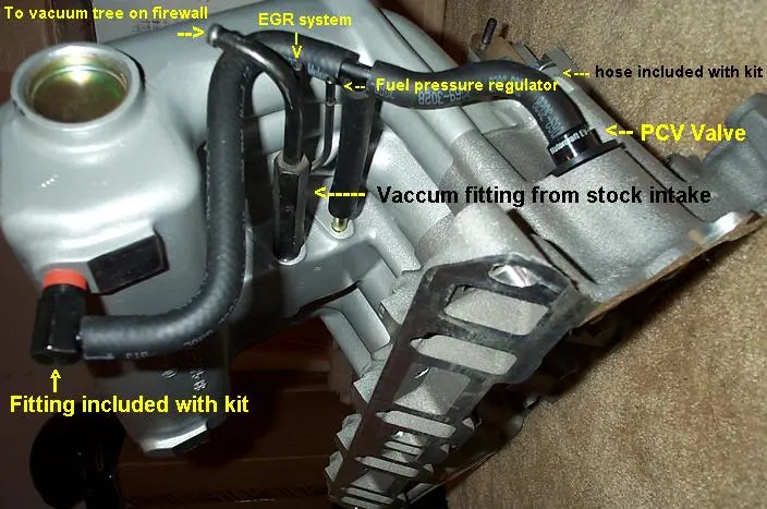

How do i hook up the lines under the intake?
in teh back underneath....one is the main vacuum line..short fat hose from the vac tree on firewall... the other 2 small ones are from the EGR valve so if your egr is GONE u dont need these (plug them) but if your egr valve is still on the car then hook them up or u will have a vac leak. not sure if there are any others..just llt me know
2 big ones up front, 2 big ones in back and 2 small ones in back
i got this one pipe that looks like it goes to the front and goes to the back with a connecting piece that hooks to another one and goes to the back off the lower intka if thats right which one in the front does it hook up to? thanks a lot
Not sure if this will help, i think it's a Cobra intake.

yeah oops i said 2 egr in the back (the small ones)...one is for egr and the other comes fro, the fule pressure regulator...
hmmm never seen an intake with 6 connections on it..your gonnaq have to wait till someone with a GT40 comes in.
OK, on the back you got one for the pcv valve, one for the egr, one for the fuel pressure regulator, and one that goes to your main vac tree. On the front you've got one that goes to your charcoal canister. If there are 2 on the front I forget where the other one goes, I'll look tomorrow and find out.
