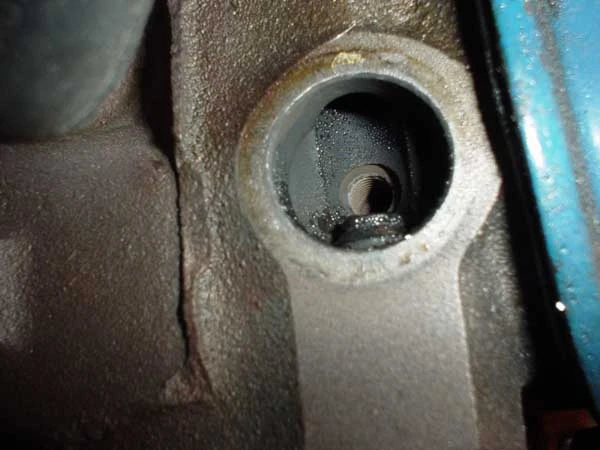

Simple Question... I have a hole in each cylinder head on the side and a hole on the top rear of the intake manifold where a bunch of stupid emissions stuff used to be that I took off.....
How do I plug these holes?? I've looked online but I can't find any plugs made for that sort of thing. I'm just inexperienced with this... and I'd rather not go buy new cylinder heads and a new intake manifold just because they "don't have the holes".... :notnice:

If youre talking about the EGR holes on the ends of the heads they are 5/8 coarse thread. I used 5/8" allen head set screws. Ford also sells threaded inserts that fit those holes but are threaded internally with 7/16 threads so you can mount acessories. As for the intake holes all you need is a pipe plug from the local hardware store.

Yes we know what you are talking about and we already answered your question. See the choke thread you started for answers there, and just get some brass plugs of the proper size and plug the holes. It's not hard.
EGR stands for Exhaust Gas Recirculation, which is a system design for emissions control. An EGR system will run exhaust gas back into the intake, which will then go back into the cylinder. The point of this is to reduce the amount NOX gas emitted by your engine. The recirculation of exhaust gas back into your cylinder will actuality reduce cylinder temp., thus reducing NOX gases. Since you will be running no emissions systems (I assume) then all you need to do is what everyone else said, and get a plug (a normal bolt will work, just as long as it threads in) and screw it in to plus the port up. I like to put Teflon around the threads instead of thread lock, but heat will "release" thread lock (unless you get heat resistive thread lock of course :D)

Actually guys, you all keep rolling your eyes at me and saying use a threaded brass plug, etc. But the hole is NOT threaded. It's a smooth surface for the rubber plug but a small screw goes through the center of it and holds it in from the far back of the hole. Take a look.
Bottom line: If I don't have to take it off then I won't. I just thought I'd be better off without it on there. And I don't want my engine overheating because I plugged up a hole that I shouldn't.

And no, the holes are on the cylinder heads... on the passenger side it's on the side above the spark plugs but all the way towards the front. On the driver's side it's above the spark plugs also, but all the way to the back of the side.
-Tim
6Stang7 said:
Hmmm, then that isn't an EGR port. What it is I have no idea, but can you post a pic of where it is.
