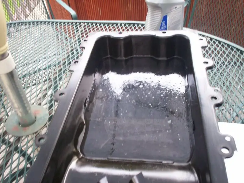

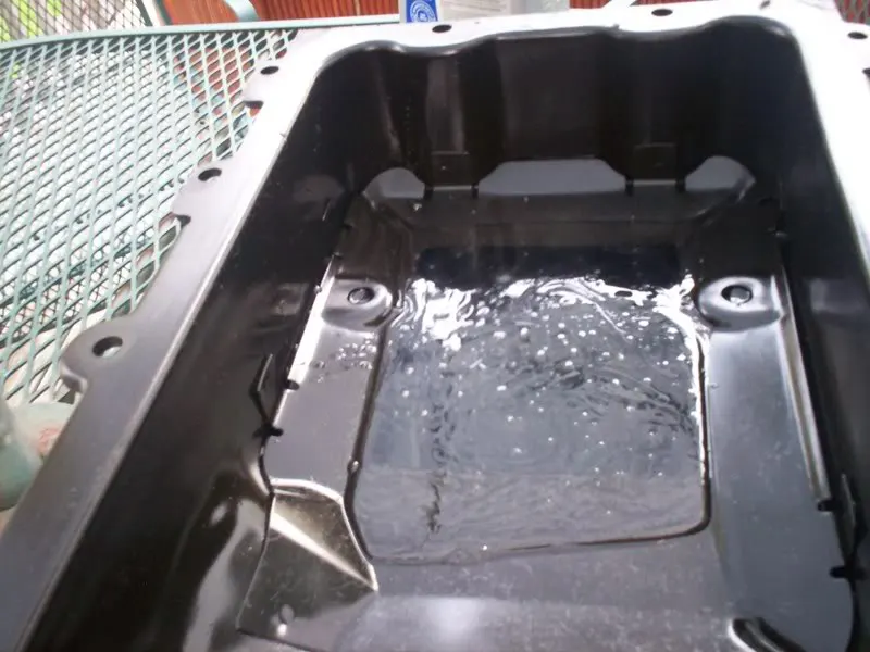

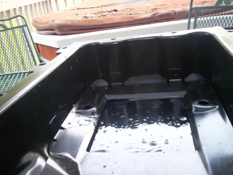

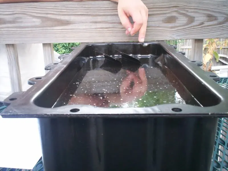

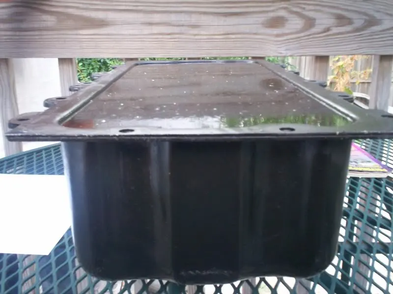

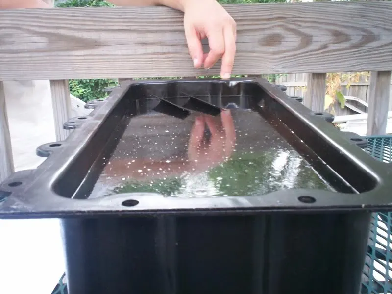

I run almost 7 in mine. Still well below the crank scrapper and far below the top of the oil pan. After 2001 ford started calling for 6 instead of 5. The pans never changed size just the dipstick reading. I have a 2000 pan with an 02 dipstick.
This is what a manual that came with a 2002 GT says.
SVTP has a great thread where a user pulled the pan and showed capacities in the pan. 7 quarts in pan still had the scapers above the oil level. plus there is never a full 7 quarts in the pan.
Stock 4.6 pan below.
2.5 Quarts
3 Quarts
4 Quarts
6 Quarts
7 Quarts
9 Quarts
