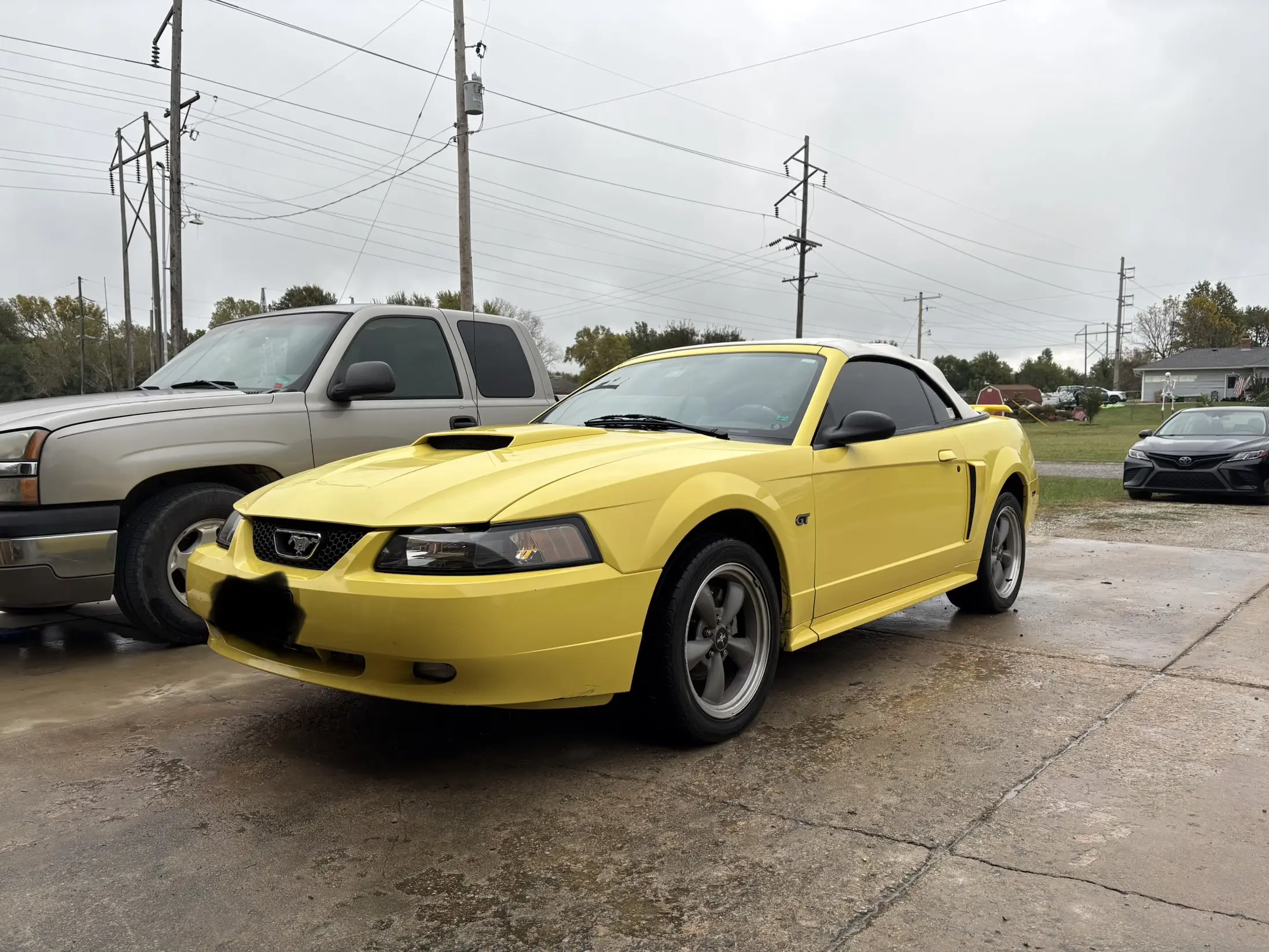

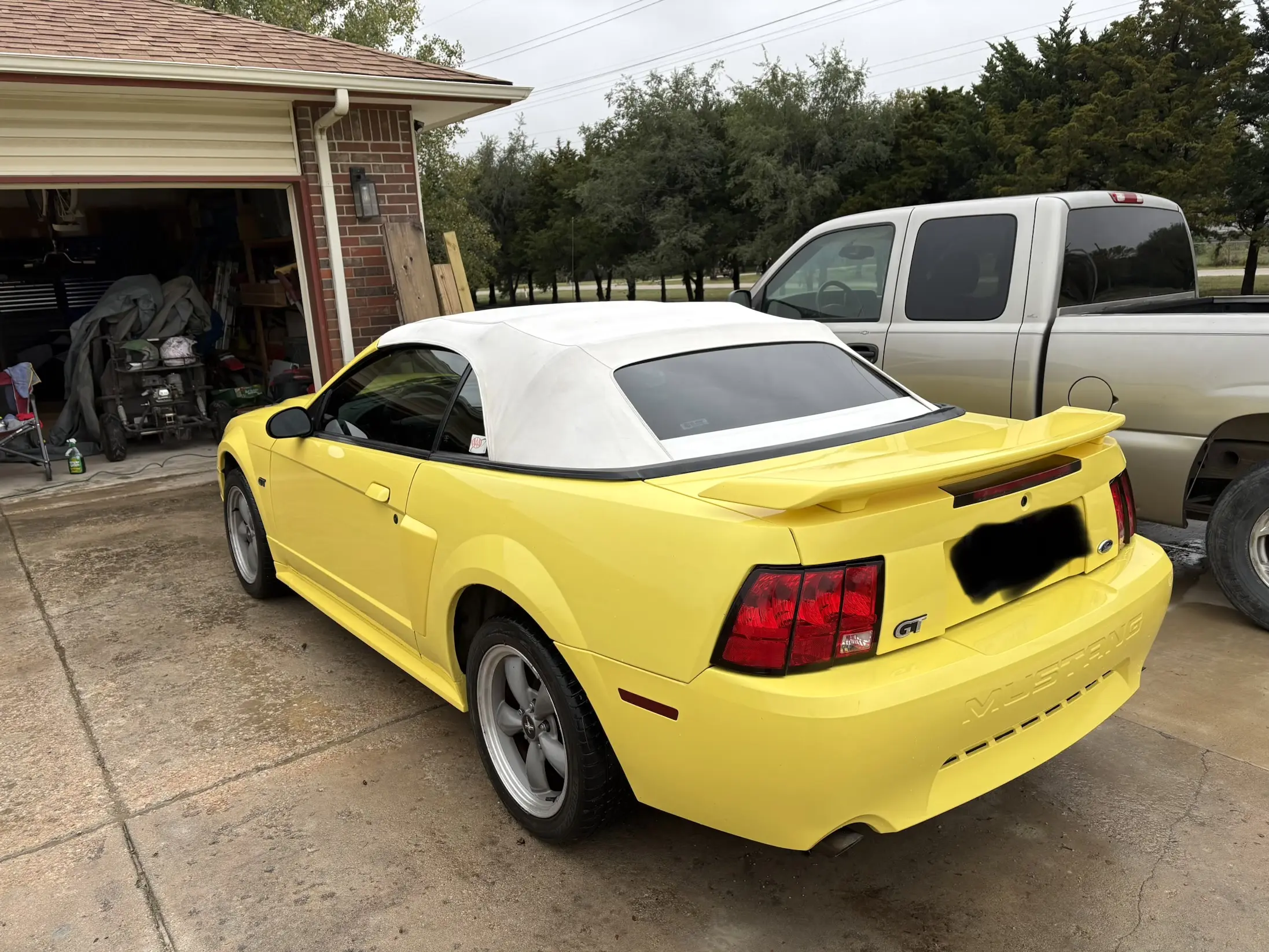

Again, thanks to everyone for reading this. Here’s some pics of the car:
