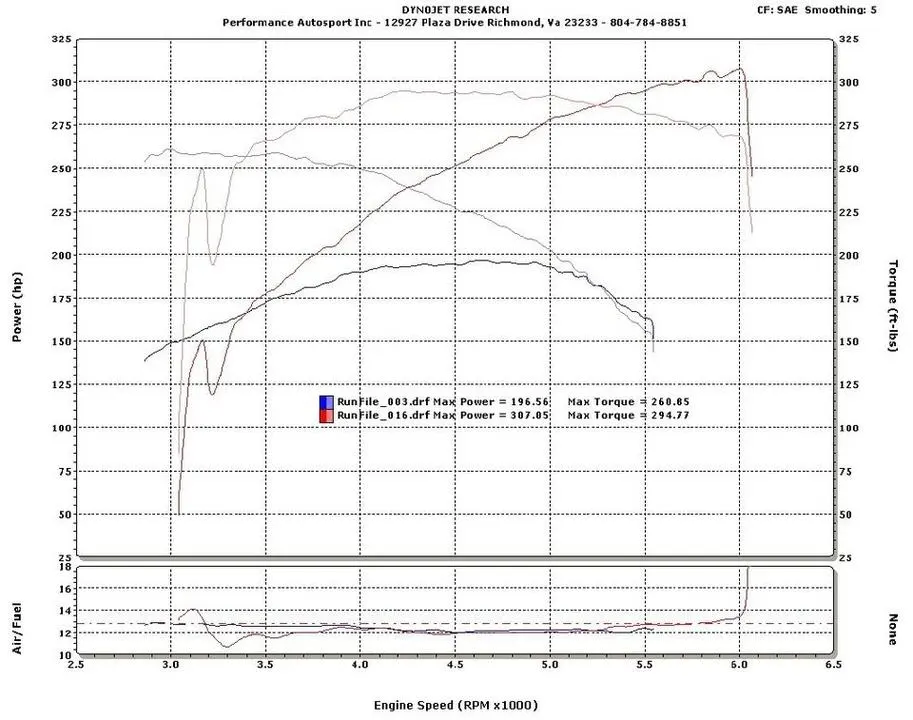

But merely stating a rwhp number without stating the rpm it makes that power is pointless during a conversation concerning how fast you are spinning the engine.
Cobra4B
Oct 11, 2000
156
Virginia Beach, VA
Sep 2, 2009
#18
  • Sep 2, 2009
  • #18
Yes.... I was joking a bit. Here's and older dyno w/ the 6000 rpm pill in. The car was tuned further w/ the 6500 rpm pill in. Shows stock 5.0 vs. the mods we did. Stock the car was dead over 5k.
