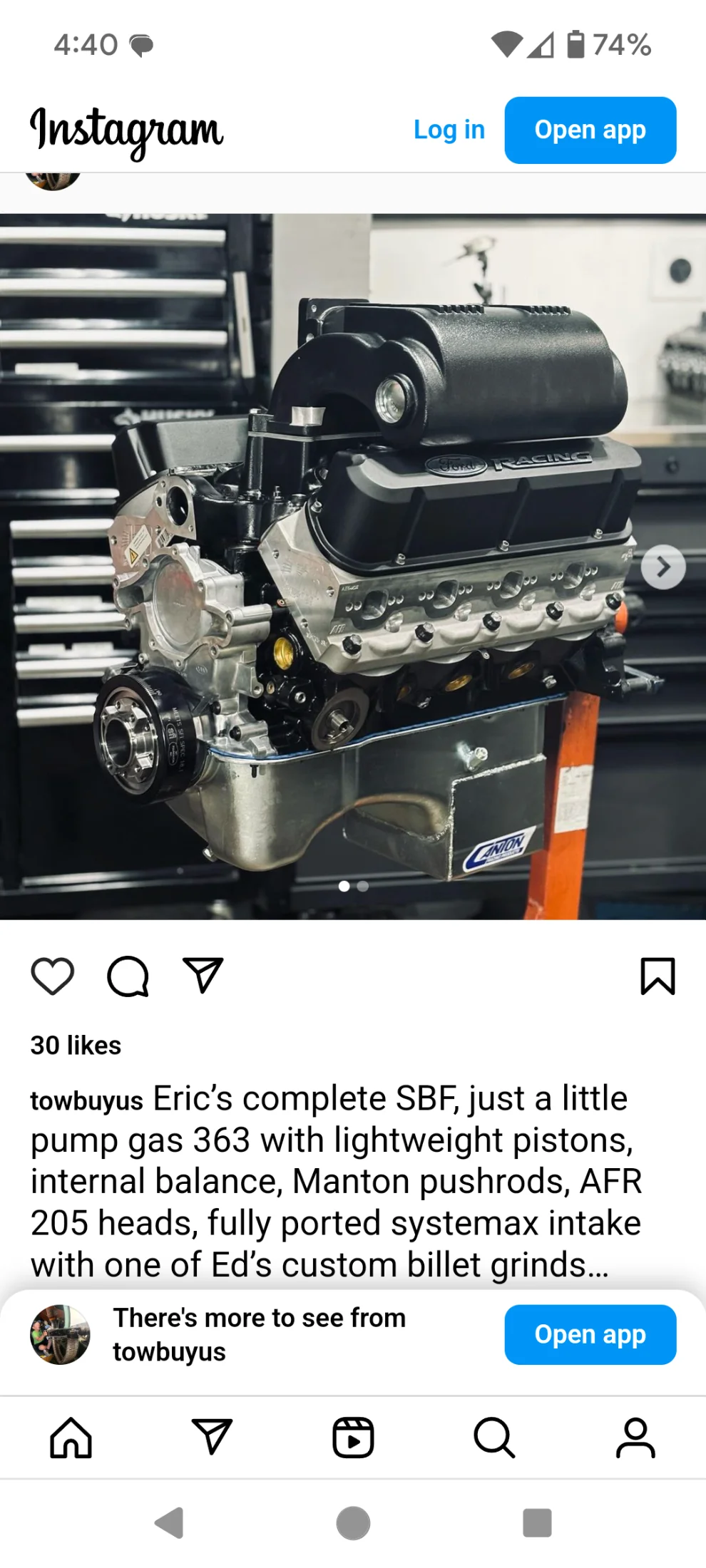

I have a fresh 363 that is a street/strip build. This build was designed by Ed Curtis and Mark O'Neal. It's built for longevity and performance.
Dart Block
Custom Ross flat top pistons
Custom 1.5, 1.5, 3.0 ring package
Vigilante H beam rods
Lightweight, nitrided RPM crank, internally balanced
Canton 7qt oil pan
Custom windage tray/crank scraper
Morel limited travel link bar lifters
AFR 205 heads built by Ed Curtis with titanium retainers and high performance PAC springs.
Manton pushrods
Ported Systemax II intake
Compression ratio is 11:1
FTI hydraulic roller billet cam .600/.616 lift
Runs on 91 pump gas!
1-3/4" MAC long tubes
2-1/2" full exhaust
Jones Maxflow mufflers (straight through)
X-pipe
80lb Deka injectors
Your choice of intake will choke the 363
AFR 205's are barely big enough if looking for peak performance
Straight through mufflers are a must if you care about power
The Deka 80 injectors leave you room to grow.
The Ford 363 crate engine requires special headers due to the raised exhaust ports of the Z heads.
You can run more compression with flat top pistons than the Ford 363 offers and still run pump gas.
My engine drives like stock. No bucking or surging. The FTI cam works.
A well thought out package makes all of the difference. The machine work is key.
Woody from Ford Strokers can set you up. Beware of any builder not familiar with the SBF Dart block and it's machining/assembly requirements.

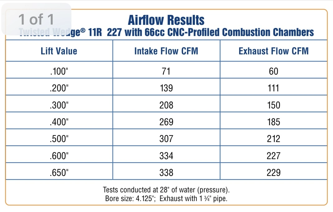

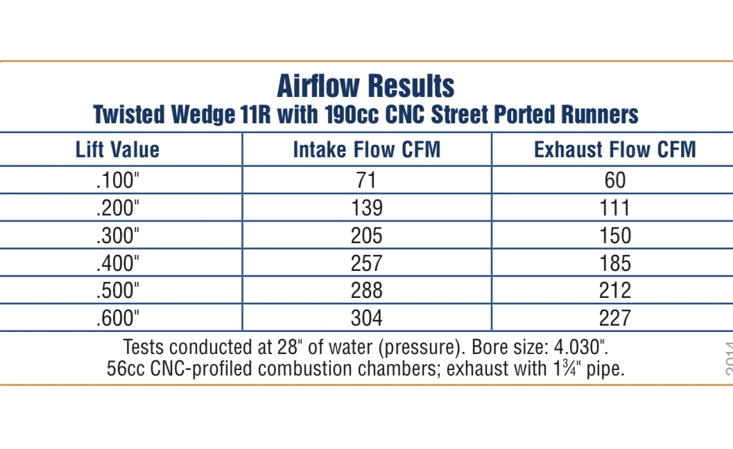

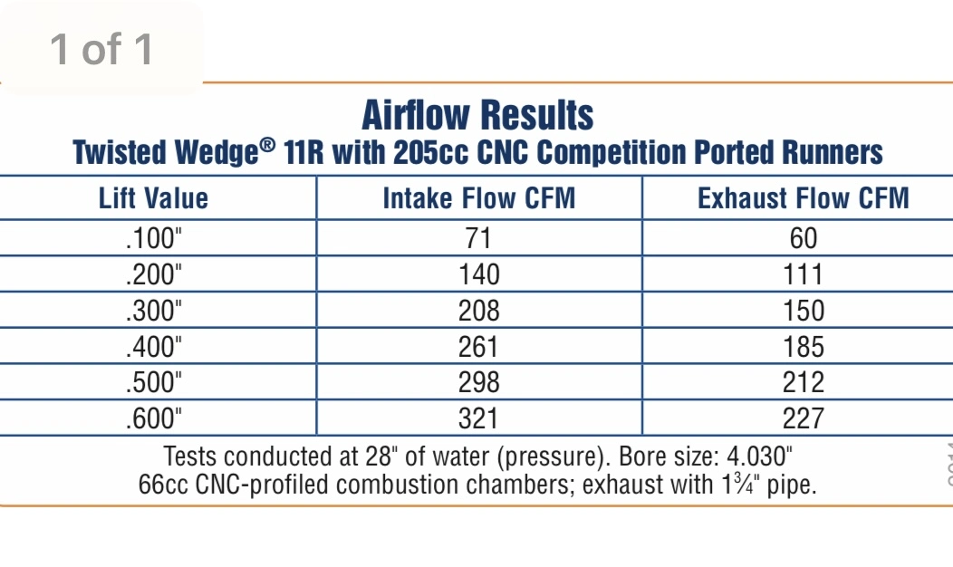

Anybody got flow numbers to add?
Head.200" In / Ex.300" In / Ex.400" In / Ex.500" In / Ex.600" In / Ex
AFR 185 (CNC “Street”)142 / 118195 / 164247 / 200276 / 210289 / 215
AFR 205 (Renegade / performance)141 / 125201 / 180251 / 211291 / 225308 / 231
AFR 220 (Competition / “race ready”)145 / 120207 / 160263 / 214299 / 225316 / 229

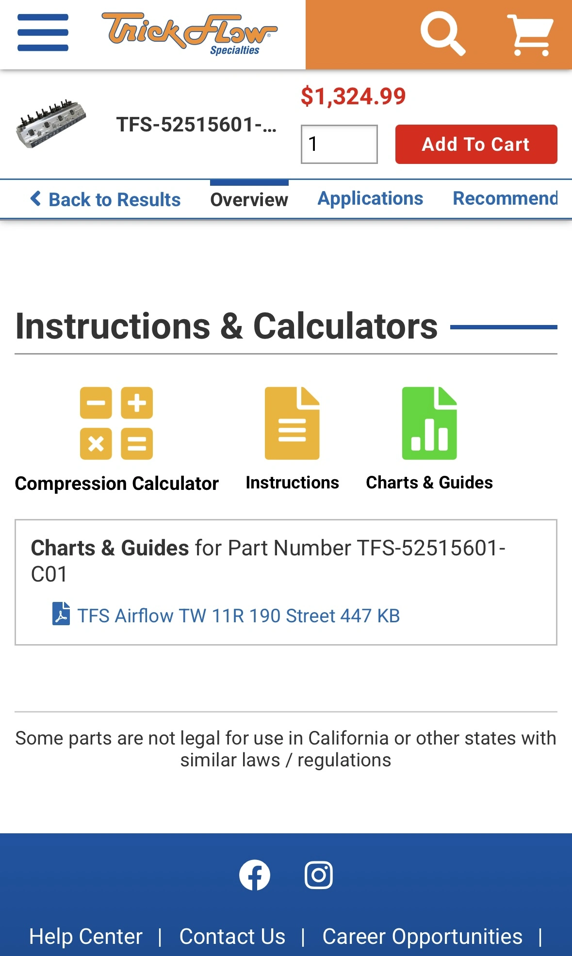

TFS 11R 190
They are readily available on TFS’s website. Select the head you are interested in, scroll to the bottom of the page and click on “charts and guides”, and then select the one with “airflow” in the title.
