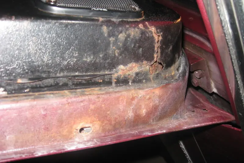

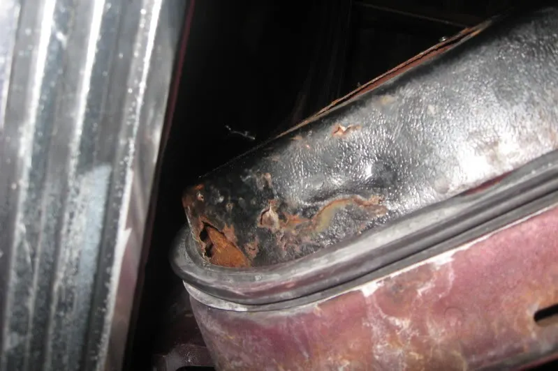

How the flark did I miss THIS??? Rust holes!
Driver's side
Passenger side
I am definitely paying for my inexperience. So do these look fixable? Wire mesh/Bondo? Patch panels? Or will I be looking for a donor car someday?
It would be very hard to patch those panels because of the texture. Do not fill with bondo!!!! If it were me I would look for a couple new/used doors. Check out craigslist in your area or place a want add on criaglist. I've had good luck with that approach for these types of parts.
It can be fixed, as shown in the pic of a 70 Cougar BOSS 302 door below. You will lose the texture, although careful patting of high-build primer with a peice of seat upholstery can approximate that. What you have to ask yourself, though, is if this part of the door is rotted through, where will it start pinholing through next? That's what happened to me when I repaired the same spot on my 66. My solution is I'm switching to repro doors.

But getting back to the doors, the repros you are referring to are the new aftermarkets, correct? I have read on here and elsewhere that those doors fit horribly and are a nightmare to get just right. Is there a specific manufacturer that has nailed it?
Also, good call on Craigslist for the used doors. Could probably find a decent pair for cheaper than the repros (even if they fit), if I keep my eye out.

I tried the used door route, got a few "clean" doors shipped in, and they were crap. Refunds on used parts are a MAJOR pain.
I got a Golden Legion door from Glazier Nolan, and had the old door off, and the new door on with latch, riser, and vent window installed in about 2 hours. Just a trial fit, of course, no painting. The top of the door at each end is not quite as good a gap curvature as the original, but easily fixable, or could be ignored if you don't care. Otherwise, an excellent fit. The car in the photo I posted has the same door, although it's (sadly) not my car. The GL door may have some minor waves in it here and there, easily corrected with a long board, and certainly better than 40+ years of beating around on a used door.
I paid $285 Cdn for the lot, both doors and both fenders :D Quite literally the price of one re-pop door. Got lucky for a change, the guy didn't need or want them. He replaced them all with re-pop pieces, I have no idea why given the near mint condition.
