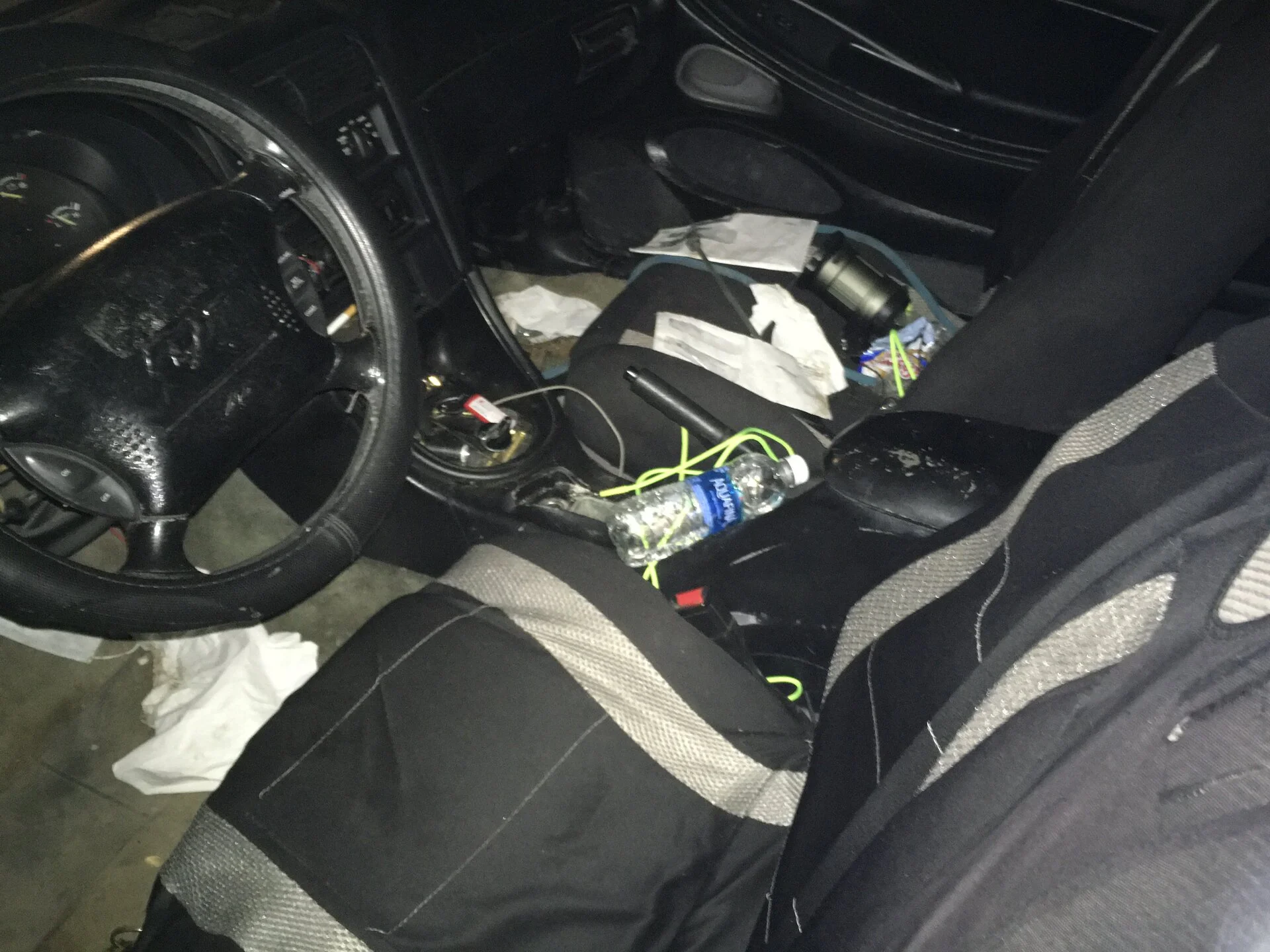

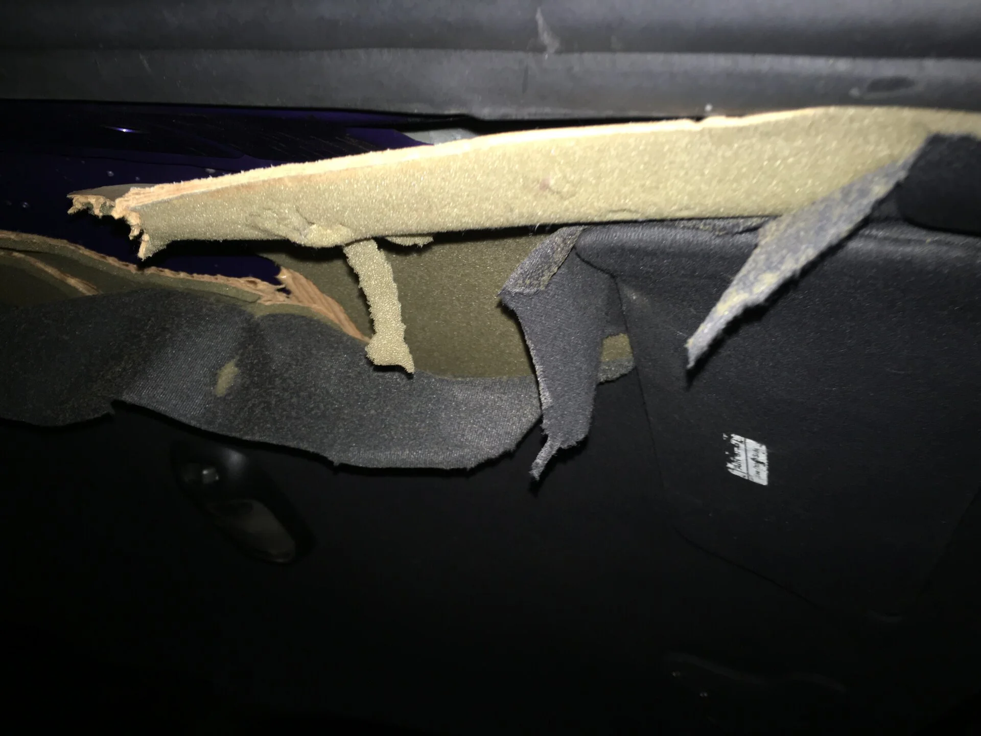

I know this is 6 months old but I hope someone replies. I have the same issue. My ‘95 GT was stolen 11/29/21, I got it back a different color, trashed, filled with food wrappers, dog food and drugs. The ¥£€#% $@& ripped the ignition housing ALL the way down one one side. Isn’t there just an “ignition lock housing replacement” we can get? I know they have it for other cars. I don’t wanna replace the whole column. Before stolen and after pix attached. Can you pick which are which? Lol
