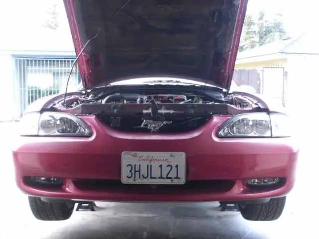

40.were all done with the install.

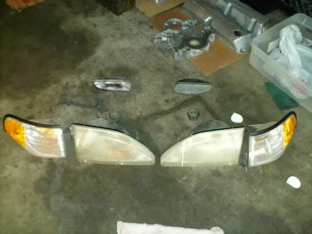

heres all the old parts.
heres the new stuff.

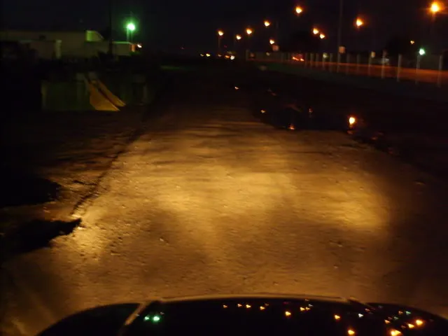

Time to adjust the lights.
i used the instructions found here.

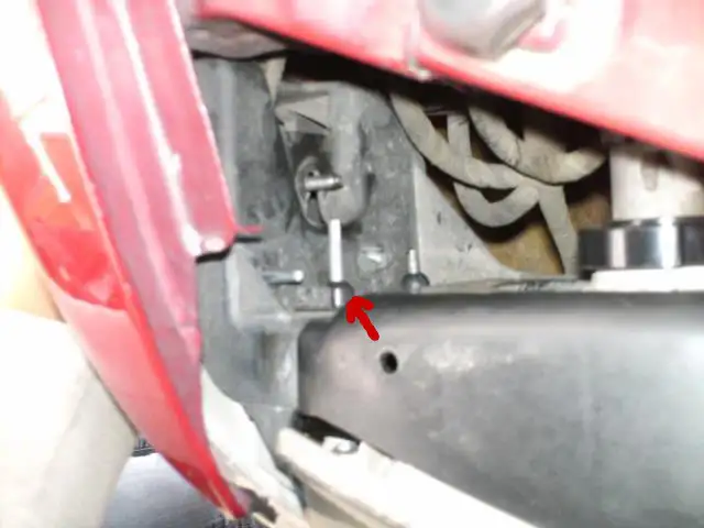

41.all you'll need is a is a 1/4 drive ratchet and a 5/32 socket.
turn this adjuster(the one with the metal clip)to move the beam up and down.this is the only one i needed to move.

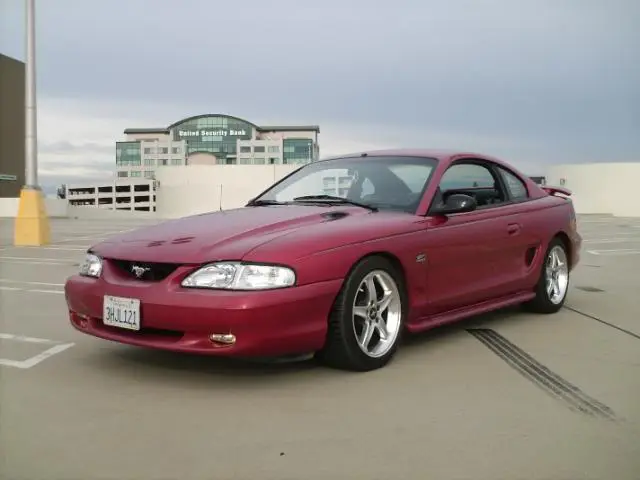

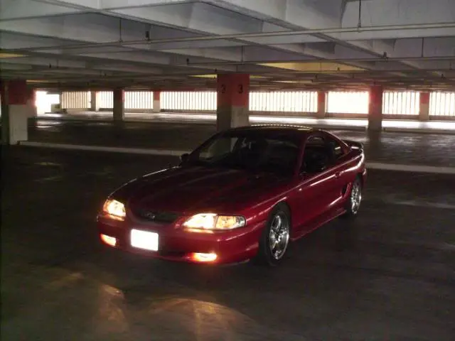

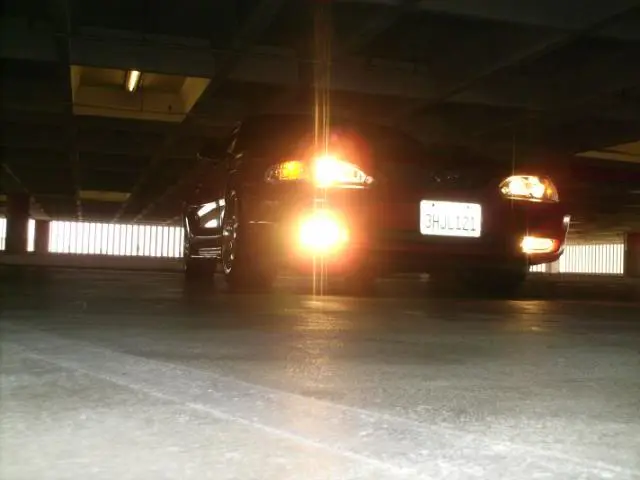

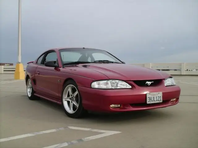

42.from 25 Feet away,heres how they look.
Old lights.
Headlghts.
Foglights only.
New Lights.
Headlights.
Foglights only.
