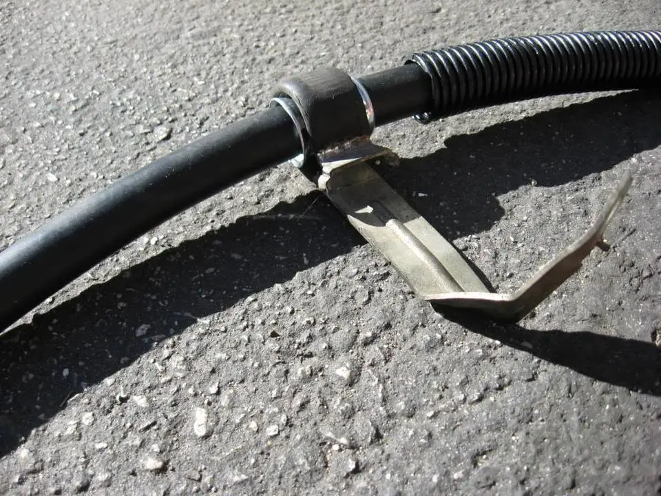

After you jack up the car and put the front on jack stands, drain out the power steering fluid. Take the cap off the pump, then disconnect the return line from the cooler. Here's a photo of my line - yours may have one of the squeeze clamps instead of the screw clamp I have. I'd replace the squeeze clamp while you have a chance, I hate those things.
Drain the fluid into an oil drain pan, unless you like getting power steering fluid all over the floor and your clothes.

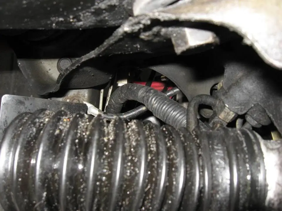

The biggest problem with this job is removing and replacing the hose fitting on the steering rack itself. After thinking about it a bit, I realized the job would be much easier if I loosened the rack-to-crossmember bolts and slid the rack forward. You'll need an 18mm deep socket for the nut and a 15mm for the bolt head on the other side of the crossmember. If you don't put a socket on the bolt, it'll rotate when you try to loosen the nut. Here's my rack pulled forward but still resting on the bolts. It's filthy under there - this hose has been leaking for a long while.

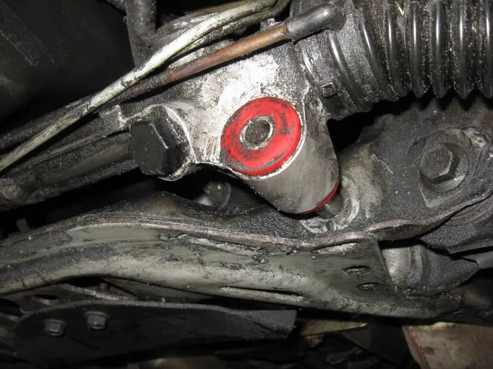

The red bushings are Prothane polyurethane bushings I put in some time ago. This is a shot showing how much room I have behind the rack. It's more than enough to get a wrench on to the fitting.

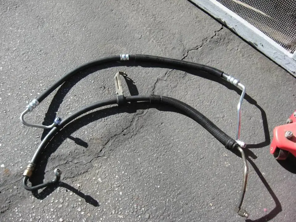

Use the same 18mm wrench you used to remove the other fitting. This part does still take a bit of patience, but the fitting does come off easily if not quickly. Set the hose aside, but we're not done with it yet. Here's the old and new hoses hide-by-side:
Note that the new hose has a metal fitting to hold the bracket that's still on the old hose. I used some wire snips to bend the crimped metal away and pried the bracket off. The new hose was thicker than the old one, but it will still do its job and hold the hose in place.
