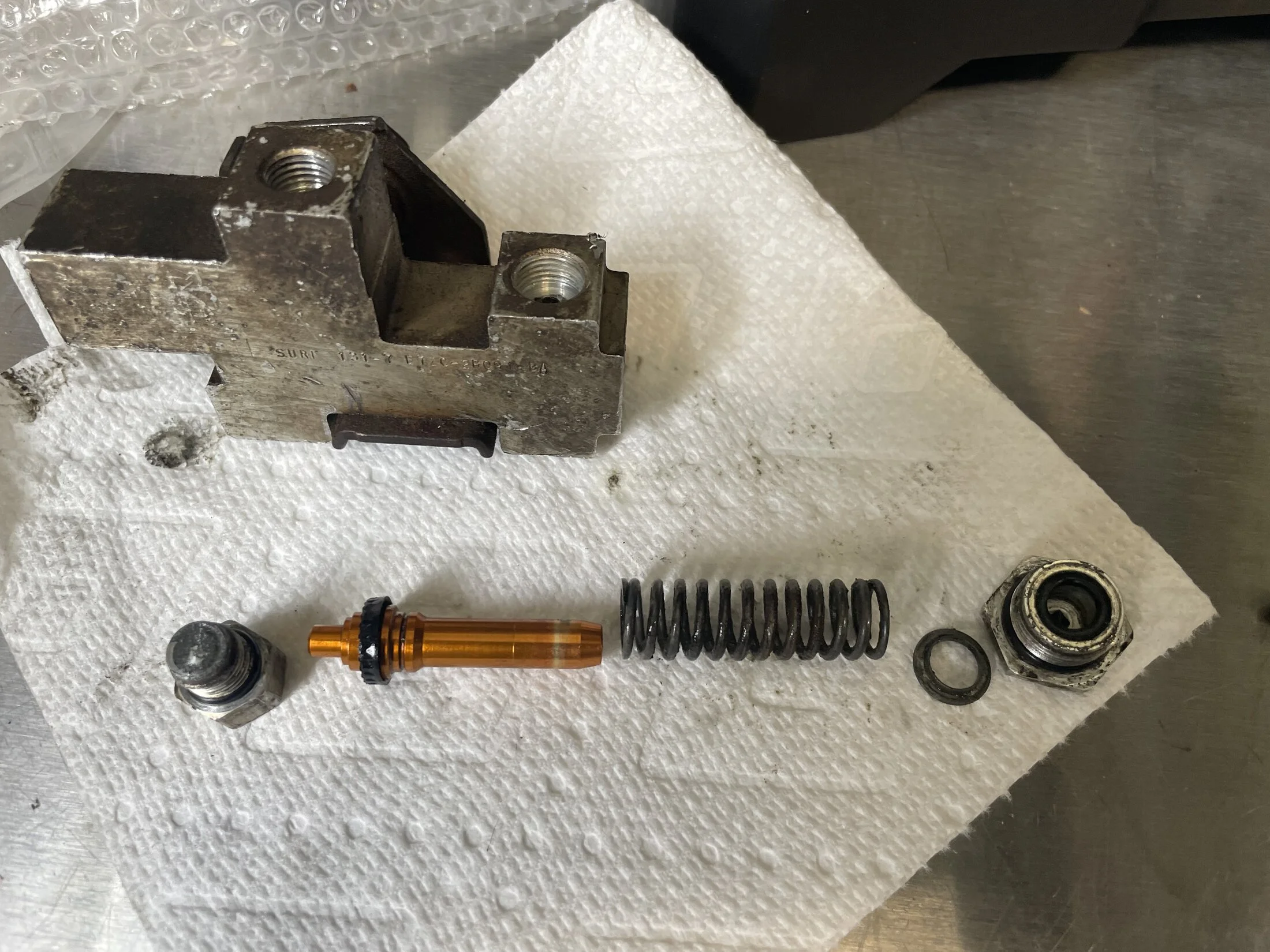

How about this one?
Other than being dirty (at least I think I’m seeing crud) it seems complete but what does the nut on the left side go to? I am looking at a diagram of the combination valve and that nut appears to be for the shuttle portion of the valve assembly. Regardless go here and they break it down really well and also offer a soft goods rebuild kit.
Thanks, great resource. I ordered the kit, but no way it will be here this weekend. I’ll put it together with the original parts, but I’ll have the replacements if there’ll a leak I can’t stop.
Yes, that bolt on the left is for the shuttle portion. I didn’t see the piston on that side, or remove it. That has me a bit worried. I’ll take a closer look tomorrow.
Thanks again!
So in the link I sent you the second picture is the shuttle valve and the third is the proportioning valve. With the pic you posed I would say the shuttle portion of your combination valve is missing?
According to that description, you are correct. I was provided the attached diagram, which has them labeled the opposite. Either way, I’m missing the valve with the smaller plug, and I believe that feeds the rear brakes. Guess I’ve always had mis-proportioned brakes?
