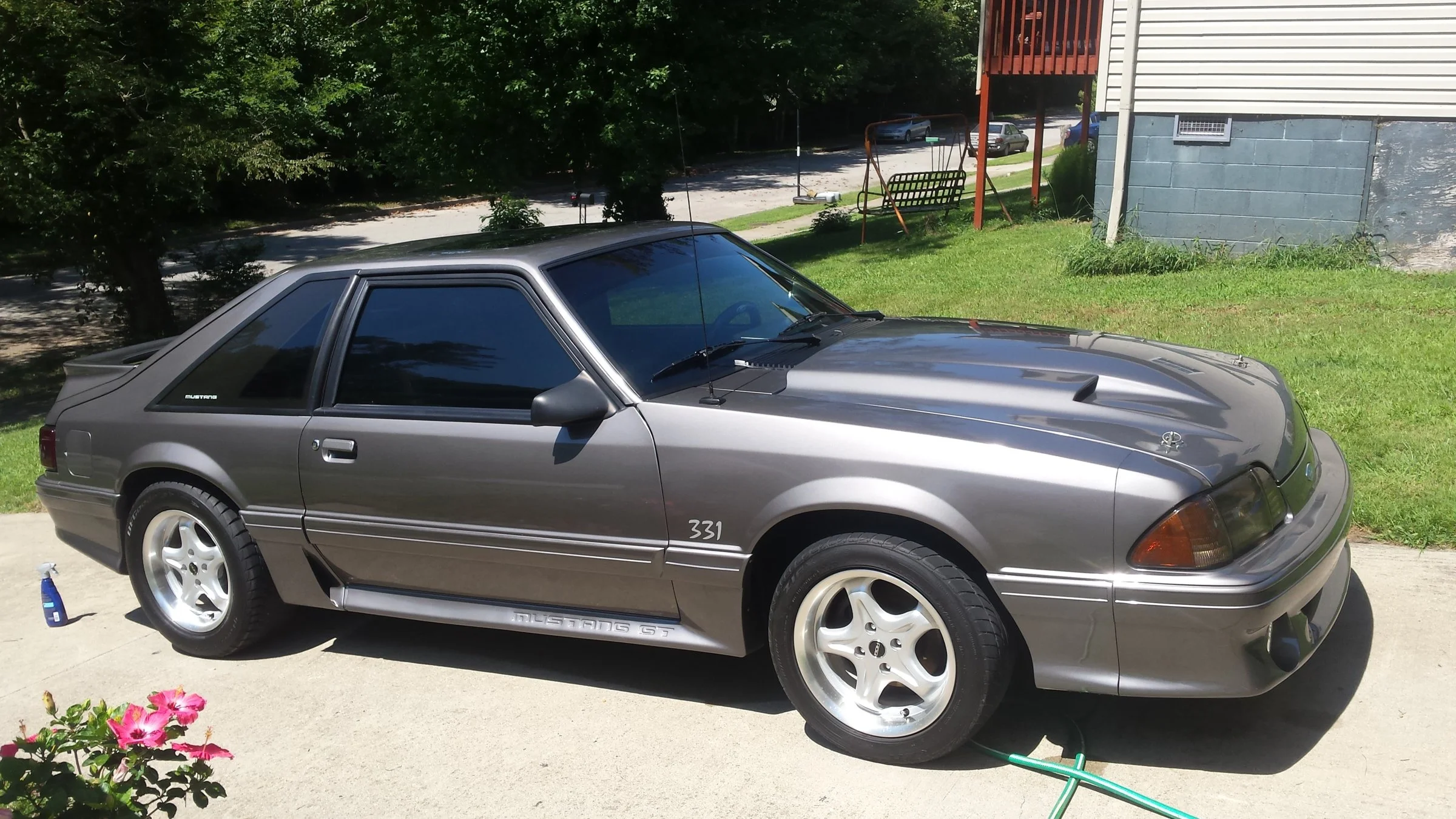

I just bought my 1st foxbody about a month ago. It has alot of up grades to it. It has an after market oil pan on it and I am not sure how much oil it holds correctly. I put 9 quarts of mobile 1 in it just to get it on the dip stick. A couple of mustang owners local have told me it's a 7 quart but 7 wouldn't read on the stick. How can I tell what's right.
It's a 331 stroker. It's was tuned at pan handle motor sports. Sorry I don't have more info. New to the mustang/car world. I do know I have a dyno charts showing 484 hp. Any help would be great. Thanks

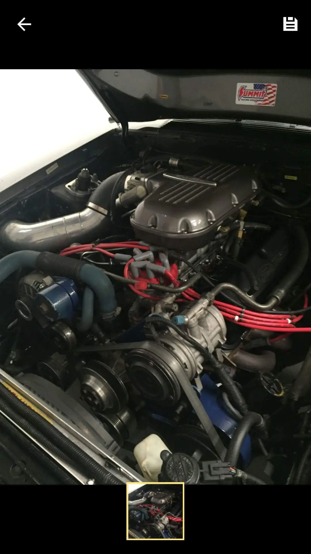

Is the car Naturally aspirated? Looks to be in the pics with an Anderson for power pipe going into the fender.
Is the horsepower at the engine or the wheels?
484rwhp is an awful lot for a 331, not impossible but not easy keeping it driveable.
It has a Anderson intake ran Into the fender. The HP at the engine at 484. I was told to that the dyno that they had done could have a 15 percent increase on it. Not really sure. I don't know alot about my stang yet , except it's fast and fun to drive
That sounds about right Figure 15%ish drivetrain loss that's what you have at the wheels
