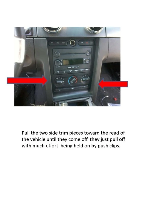

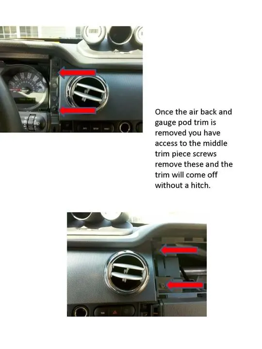

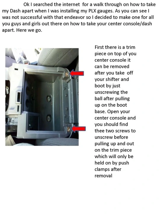

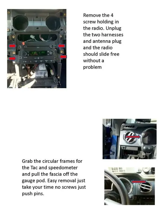

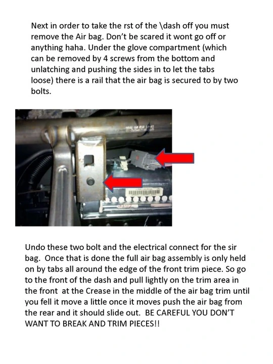

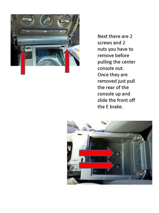

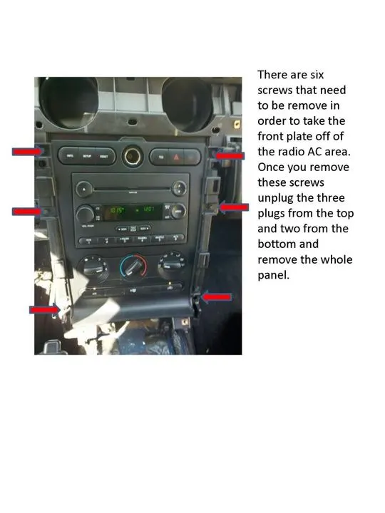

A ae_07mustang New Member Oct 18, 2010 5 0 0 Niceville Feb 24, 2011 #1 Feb 24, 2011 #1 This is my first write up so please give me feed back on how i could make it better.[/quote]
geosnake08 New Member Apr 11, 2011 4 0 0 Illinois Apr 13, 2011 #2 Apr 13, 2011 #2 Nice job. The pics are good and the red arrows are on the mark. This will save me some headaches in the near future...Thanks
R Rhymhoont New Member Feb 14, 2011 29 0 0 Apr 14, 2011 #4 Apr 14, 2011 #4 Very well done! Thank you. My only scare was the air bag. As a firefighter, these things are deadly. They are solid rocket boosters in there you know... They are not a pillow. So take care with static when messing with them.
