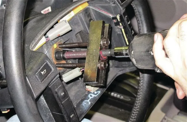

For the record...there is the main shaft under the cover on the steering wheel that you remove exposing a NUT, NOT a bolt...on it. You remove the NUT.
When you remove the cover, there will be two holes that a puller bolts into. The threaded insert on the puller threads through the puller. Once threaded through the puller, you place the provided pivot end on the puller that threads against the main shaft that you removed the nut off of. Then you start to tighten down the threaded insert. That action will force the steering wheel to pull off of the shaft.

The smaller bolts should be pulling the wheel off as you tighten the large middle bolt. That pushes against the main shaft, and the smaller ones pull the wheel off. If those small ones are bending, something is set up wrong.

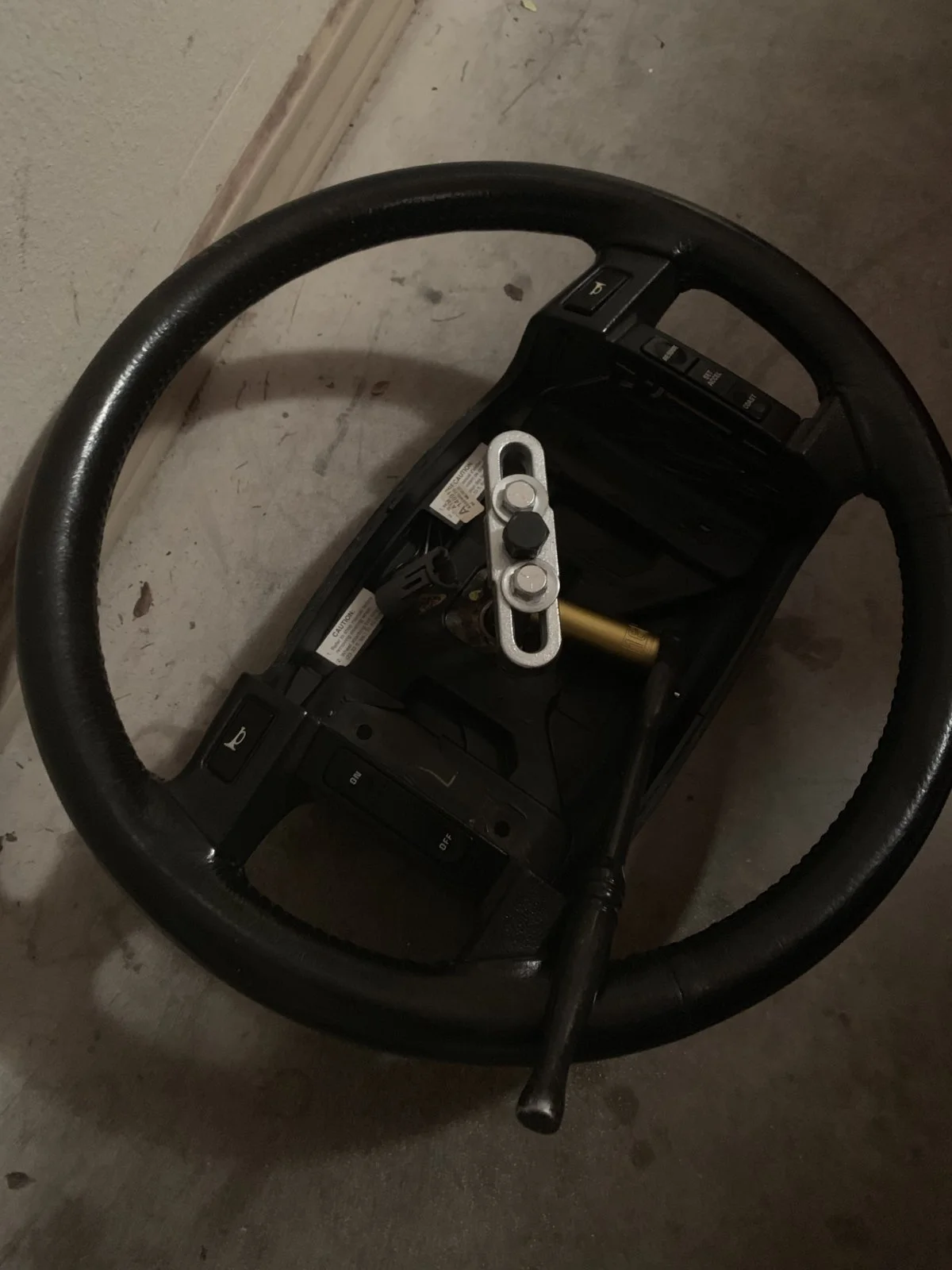

Regardless though..the puller should look like this when properly installed.
Reactions: Wayne Waldrep and Rdub6

That's how I had to, but as I kept ratcheting the center black bolt tighter and tighter, the 2 side bolts bent. The steering wheel is jammed on I think.

No I pulled mine not to long ago with an autozone cheap rent a tool. I got the airbag block off which I kept thinking this thing is gonna blow up in my face! loosened bolt and removed, put the remover on threaded in the two bolts that fit and used the small spacer started cranking and the damn thing just busted off, bent one of the bolts. I ended up going to Home Depot, bought the same two bolts and this time I threaded the down as tight as I could get them, tightened the main center pulled part and it popped right off. I think I messed up by not cranking the two stabilizing bolts down as tight as I could get them.

Yeah that’s what I ended up doing, I just said screw whether they were right thread or not just sink them down as tight as you can. I think the mistake was not doing that and just sort or lightly cranking them down, and once the force was given they just snapped out.
