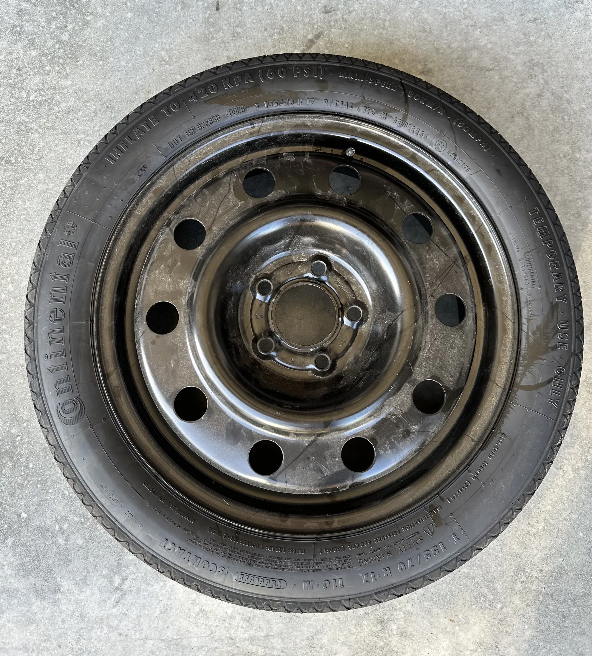

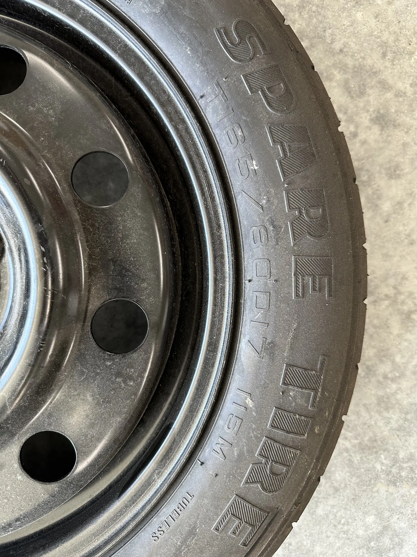

So what brought this on for me was I have been carrying one of the V6/GT spares since I converted the Coupe about 20 years ago and one in the T-Bird for about 15 years. Both cars have had staggered setups on them for the last 10 years so the whole moving a rear wheel up front thing has been out the window and I have just been lucky with the few miles they get driven. I ran across this thread on the Corral which list the 07-14 Ford Edge as a solution but the tire on them is a T165/80/D17 (roughly a 26.5" diameter) and the tire on the Cobra/Mach 1/Bullitt is a T155/70R17 (roughly a 25.5" diameter) so there is roughly 1" of diameter difference.

So this weekend I went to a U-Pull It salvage yard and they had about 10 Edge's in the 07-14 range and I was able to get two really nice (doubt they have ever been run) spares and the washer that helps hold them down. I wanted the wing nuts as they were a really nice design but it is a different thread than the Fox Mustang and the Edges have a stud that screws directly into the bottom of the spare wheel well of the car vs the Fox Mustang stud which hooks into a loop welded to the spare wheel well bottom so I could not use the Edge stud.

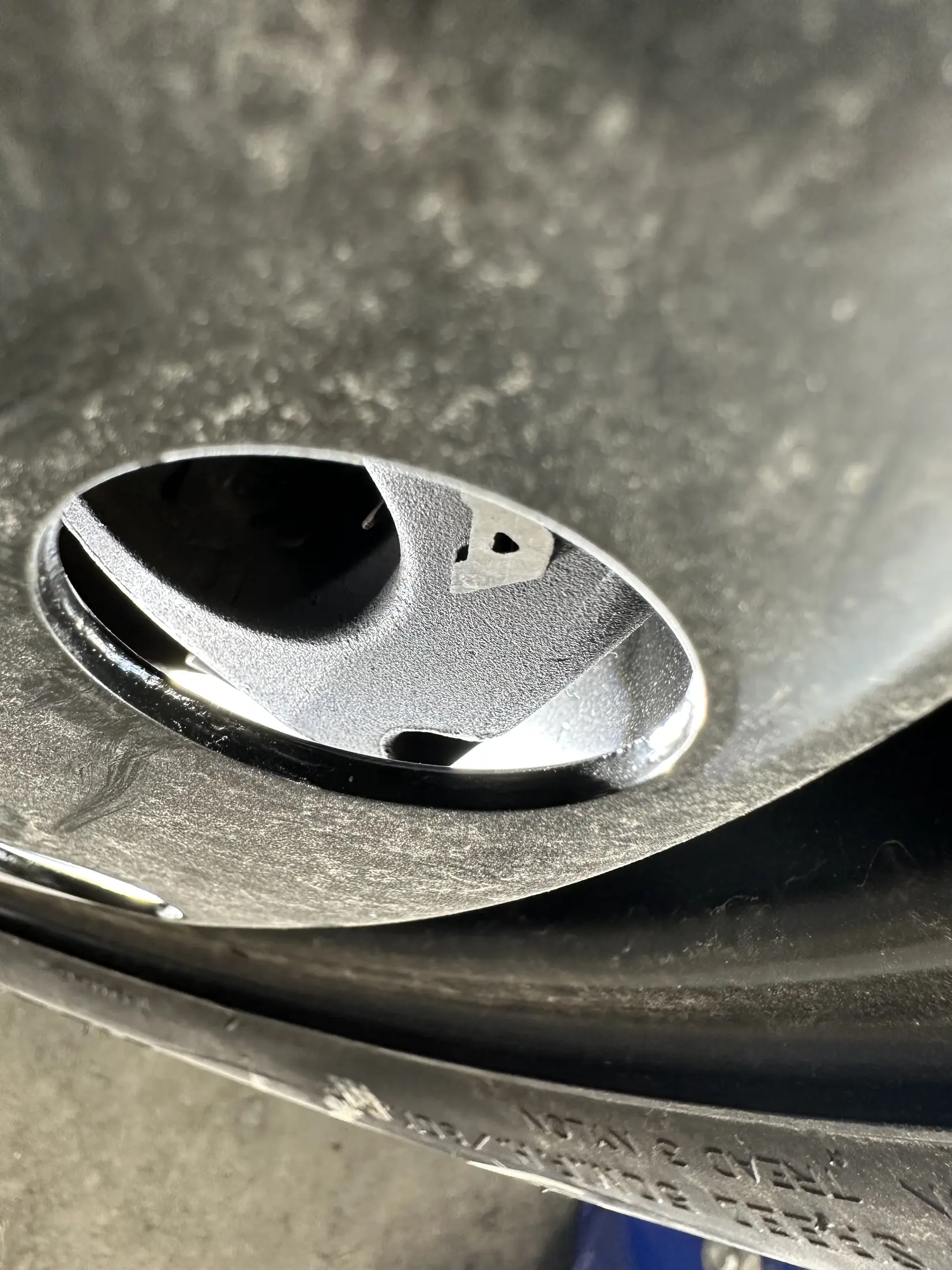

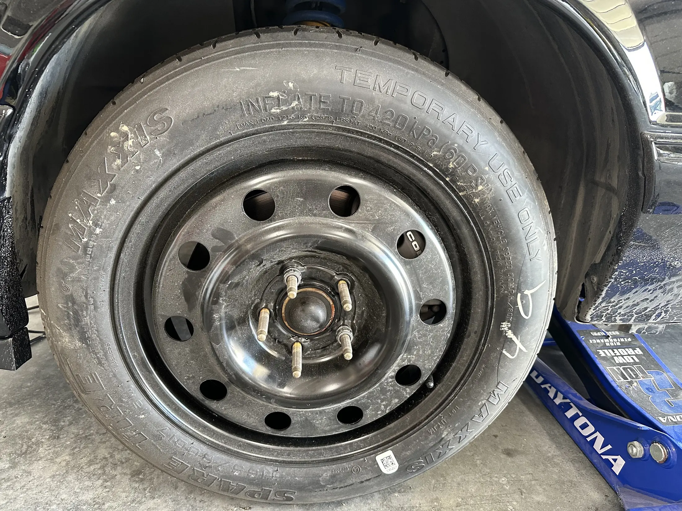

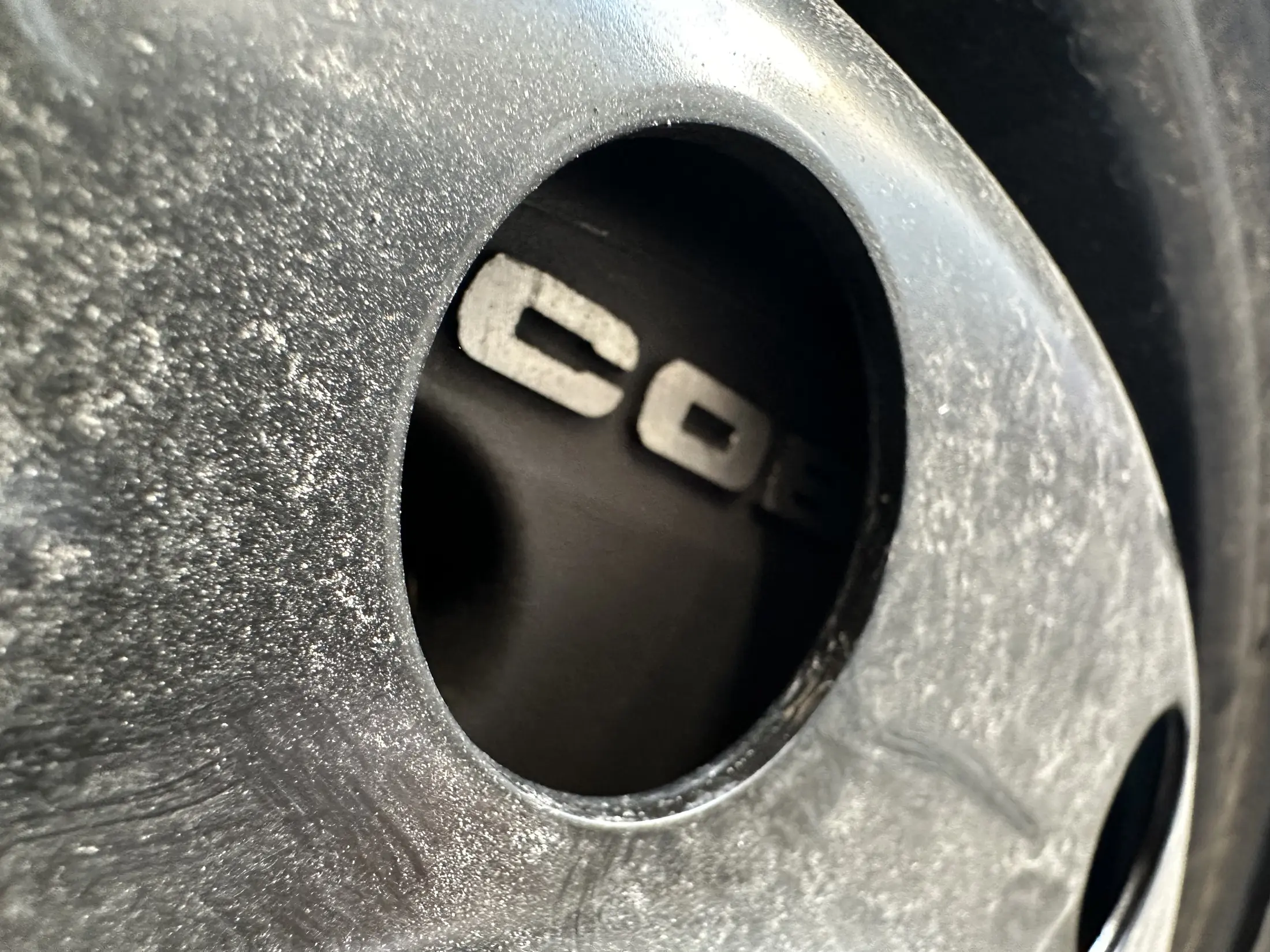

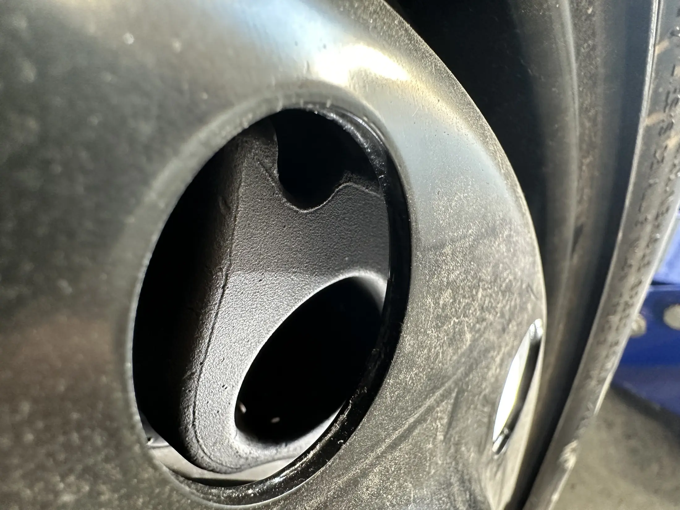

Pulled one of the front wheels of the Coupe and mounted the spare and it clears the Cobra Caliper by about 1/4" at the tightest spot. Couple of pictures of the spare installed (car is still jacked up), the tire size, and three of the clearance:
The last two pictures I was able to get a light behind the wheel and back light it. Wish I would have retaken the first pic that had no back light.
Dropped the car down on the spare and its too close the inner fender for me (my car is a full MM car and it is pretty low) so I am going to replace the existing tires with T155/70R17's as the T-Bird is a Griggs Racing suspension car and is pretty low as well.

Anyhow, this is proof that the 07-14 Edge spare wheel clears the Cobra front brakes.

I will say the 155 fits on the spare well but you are not getting anything taller in there. The 145 would drop right in if that matches you tire size better.

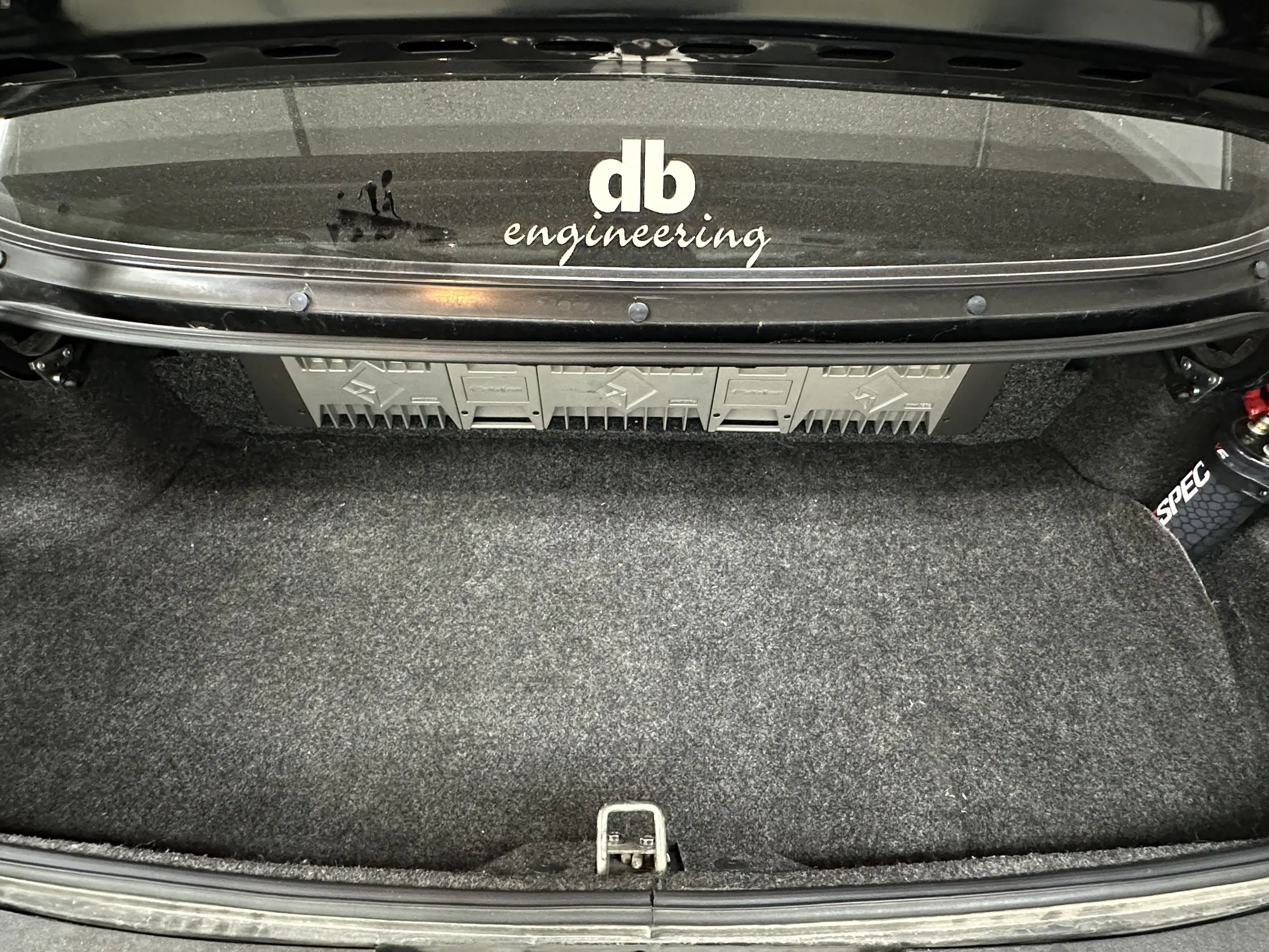

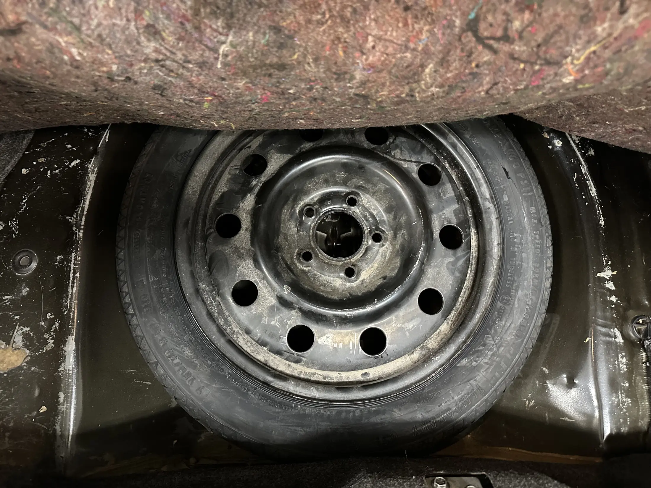

It’s tight going in and out due to the sub box and amps but it goes in without much effort.

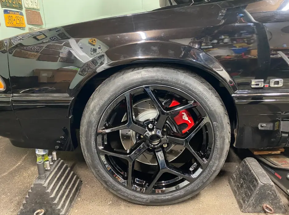

I managed to find a decent Cobra 17" spare for my '00 GT with cobra brakes.
On my '88, I was originally planning on running ATS brembos. The cobra spare obviously will not fit that. I later found out my C5 PBR's will not clear the cobra spare either, so I needed another solution.
I stole this from another person but my solution was to buy a racestar recluse in 18x5" and put a spare on that. Clears the ATS brembos, and proper OD. It sits low in the hatch and fits inside the well. At the time it was a $130 rim. Forget what i paid for the spare tire. I was originally going to have a 1998 cobra wheel cut down to 4-5" but this was cheaper. The big thing was it clears the ATS brembos, which unfortunately I never ended up doing.
