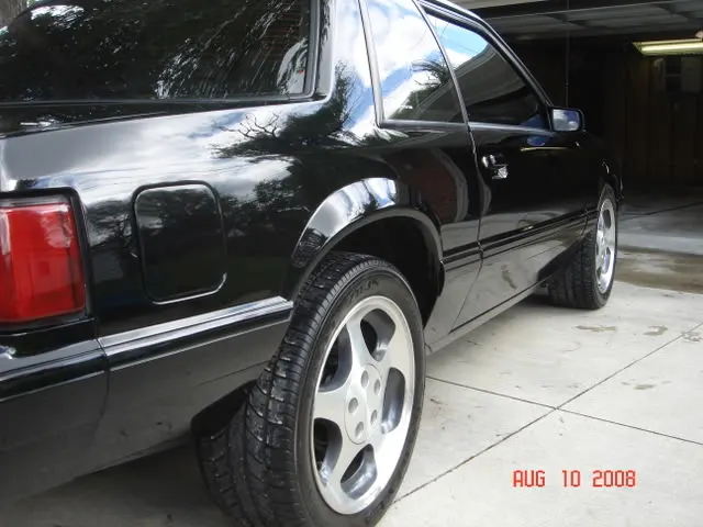

Nason products are a line from Dupont. The paint and clear is fine. All I've ever used is Nason clear. My supplier told me the Dupont is supposed to shine more, but it is more money, and I can't imagine anything shining more than Nason. This is Nason clear.
Friends GT I painted using Dupont black and Nason clear. 4 coats of paint, 3 coats of clear.
