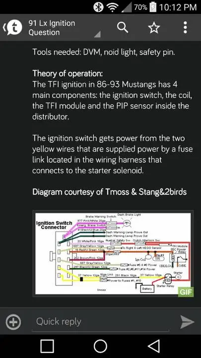

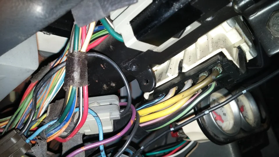

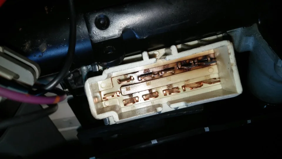

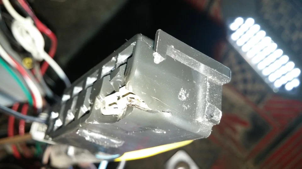

Then I do then, cause I've done that several times and it still cranks. The two yellow ignition wires melted and are touching. I tested by getting continuity between them. I came across it doing testing other night

Good catch. That switch is prone to melting. Check the wiring leading to the switch while you have everything open as the wiring also tends to melt.
