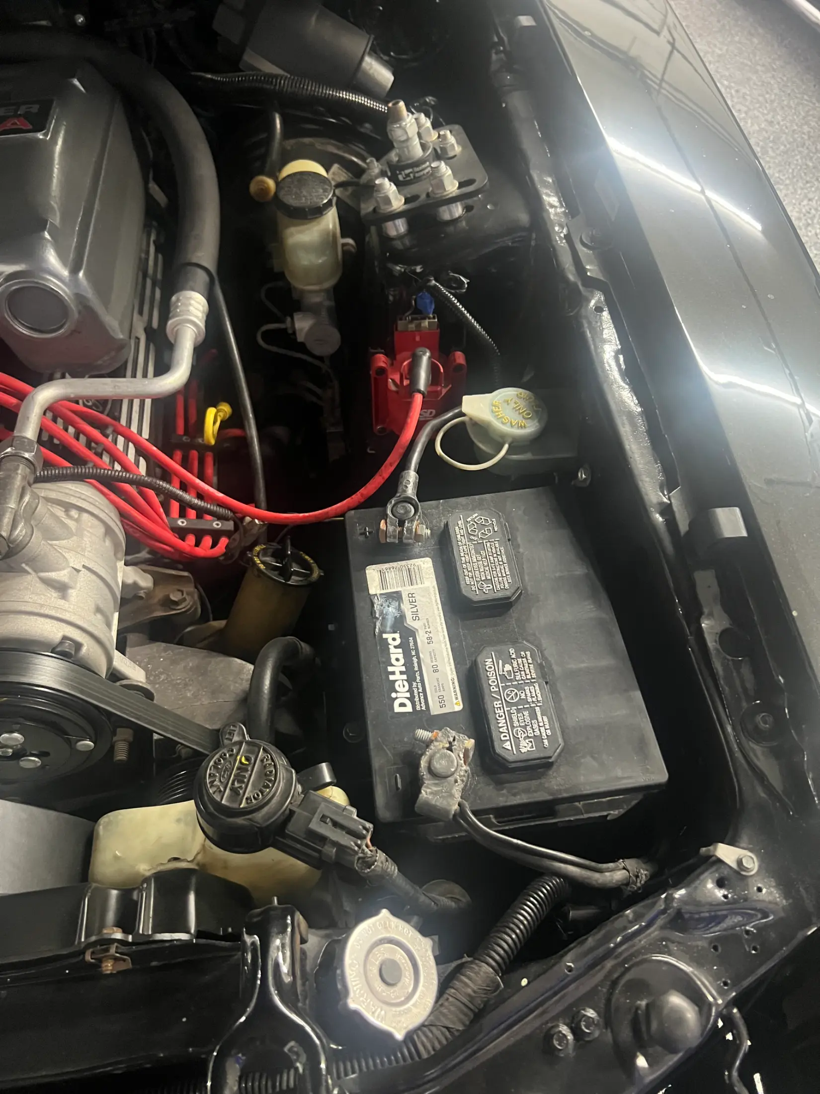

What kind of terminal do you already have on the battery? Picture would be best.
Here’s a pic, it’s just the normal stock style I believe. I had to get a aftermarket longer positive one for my wire tuck.

Something like this if you do not want to cut the 12V+ cable.
View: https://www.youtube.com/watch?v=kaMH1mEGYkQ
Nice, I’ll get something like that. LMR says to leave your factory power wire and add the upgraded one along with it, but I’ve read a lot in this forum say to remove the stock power wire and just run the single upgraded one.
I’m wondering, since I can’t reach my starter solenoid, would I be ok if I only disconnect the stock power wire on the alternator side and just terminate that end, leaving the solenoid side connected? Or am I ok just leaving the stock wire fully connected as LMR shows in their instructions?

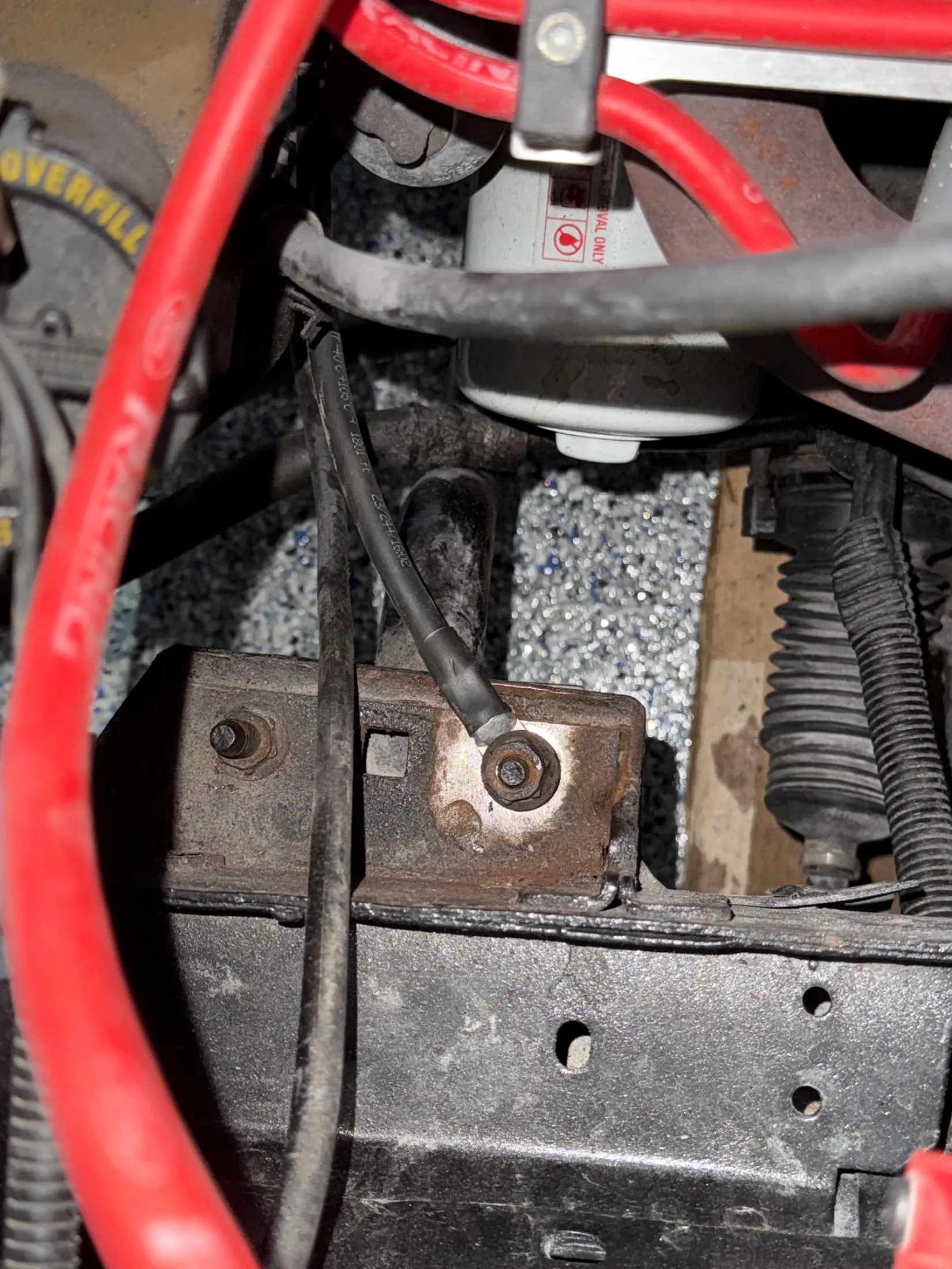

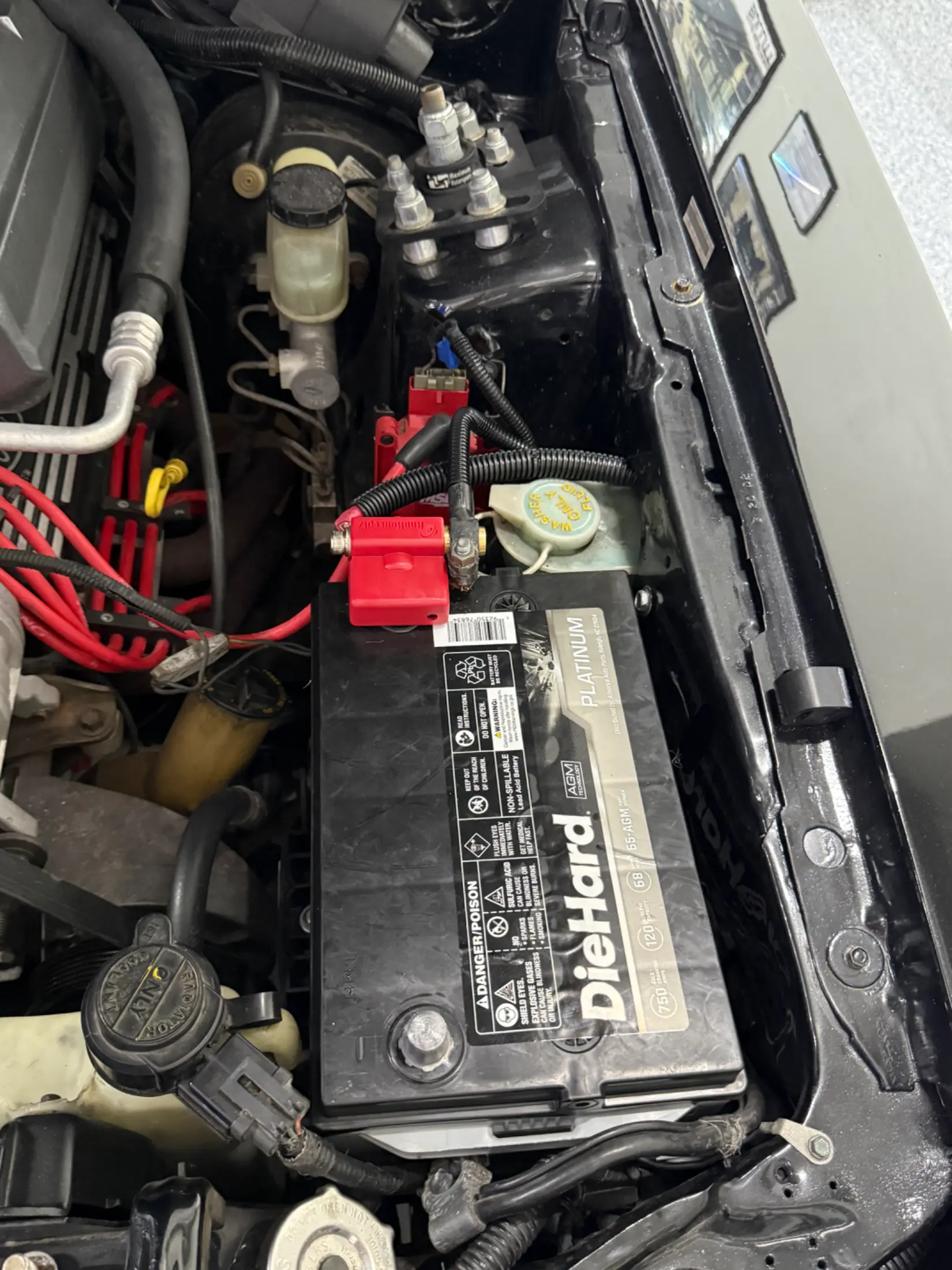

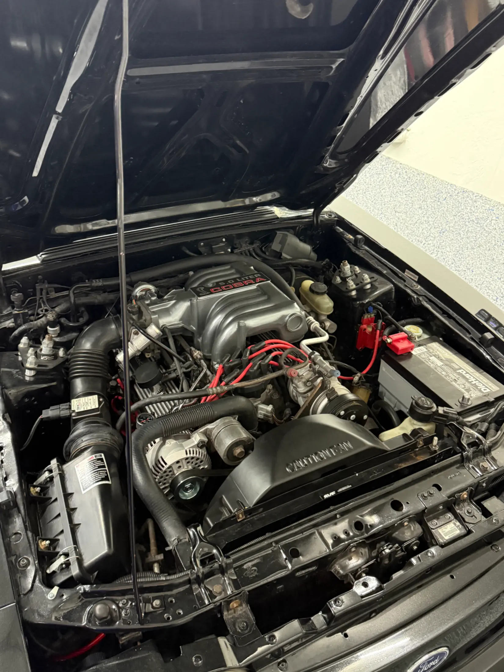

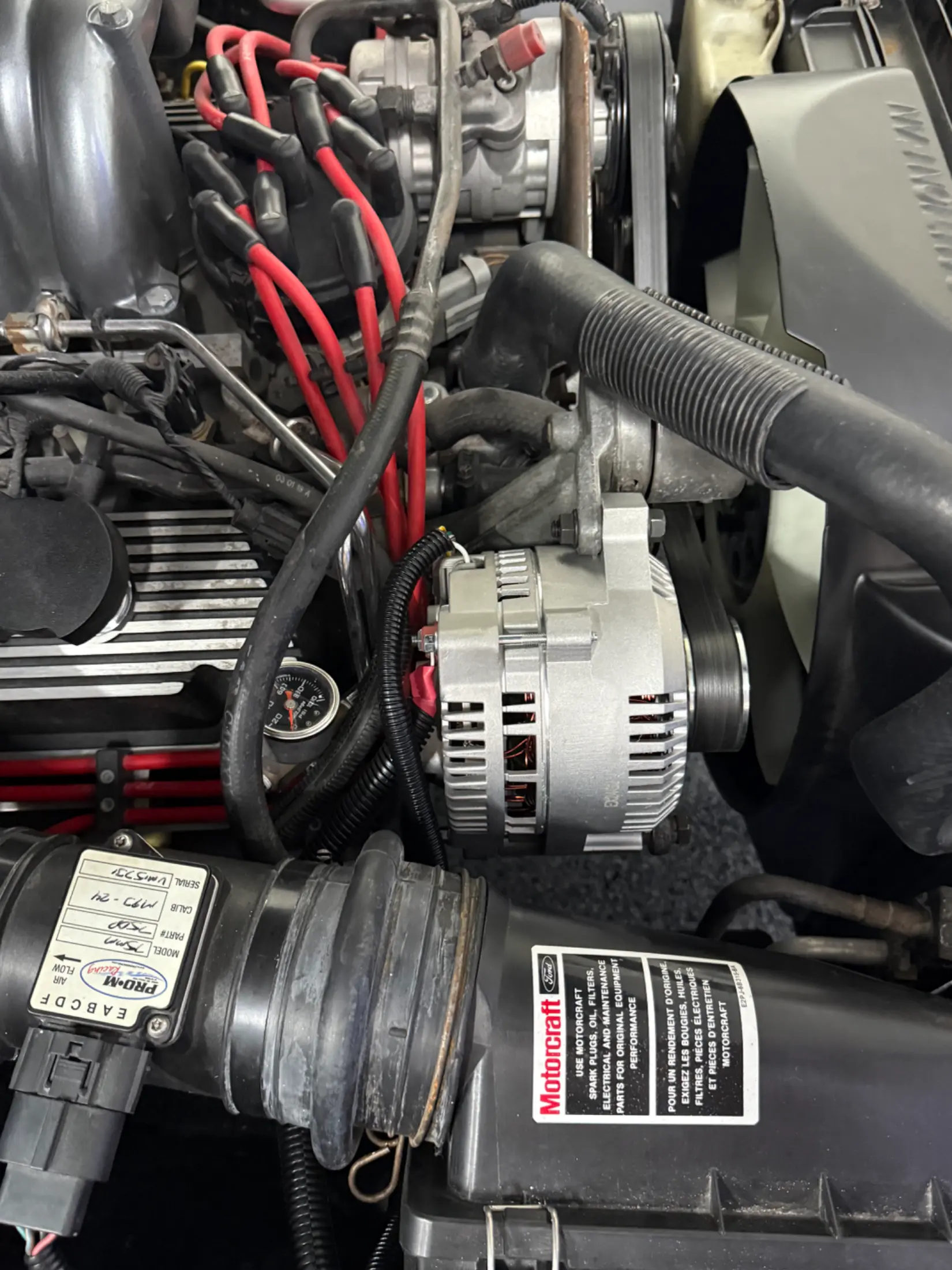

I did the install today. Check out how it came out. I paired the new alternator with a new upgraded bigger group 65 agm battery. The car should run great now I can’t wait to see.
I’m pretty sure I did it right but I just want to verify with you guys. In that last pic is the 4ga block to frame ground I added. I went from the factory negative battery cable ground location on the drivers side engine block, to the top of the sway bar bracket. Is this a proper ground for this?

750/120 ... Yep, that's a pretty big battery. :D
Your grounds should be just fine. If you ever start detecting a noise in audio systems etc... , go back change the last ground you made or modified.
I have successfully installed a ground-loop in my 86 that took me a bit to find and diagnose. I had a thousand, "You need new plugs with resistors!" responses. :doh:
