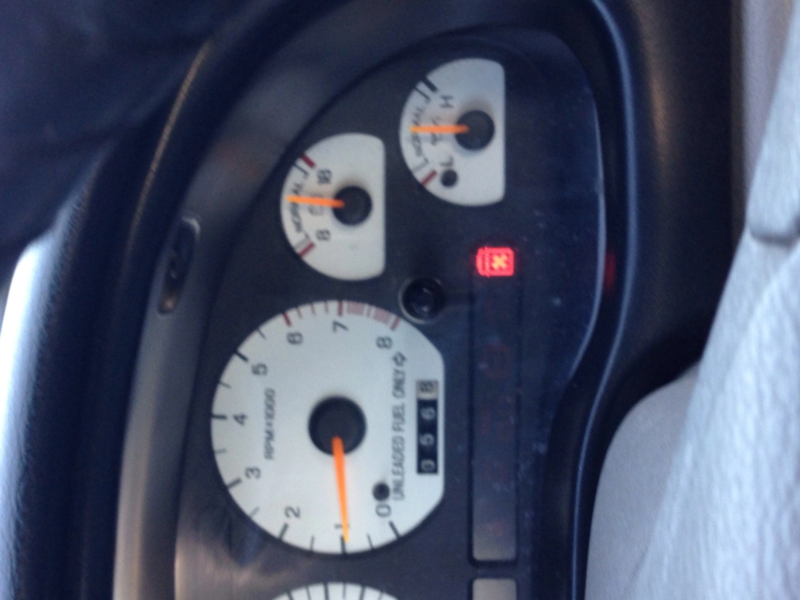

Wes medina New Member Sep 22, 2013 5 0 2 Miami, Florida Sep 22, 2013 #1 Sep 22, 2013 #1 I have a 1997 gt and on the dash this light pop out yesterday and I've never seen it before and idk what it is
wmburns SN Certified Technician Aug 14, 2009 5,892 514 204 Houston Texas Sep 22, 2013 #2 Sep 22, 2013 #2 Low coolant level in the de-gas bottle. The dash light is a radiator symbol. If the coolant level is correct, check the de-gas float sensor as it often will stick.
Wes medina New Member Sep 22, 2013 5 0 2 Miami, Florida Sep 22, 2013 #3 Sep 22, 2013 #3 wmburns said: Low coolant level in the de-gas bottle. The dash light is a radiator symbol. If the coolant level is correct, check the de-gas float sensor as it often will stick. Click to expand... Thanks I'm going to check that out in a few I'll keep you posted
madspeed Colonel Mustard Founding Member Nov 29, 1999 8,914 1,332 204 a van down by the river Sep 22, 2013 #4 Sep 22, 2013 #4 must be very low if the light popped out
