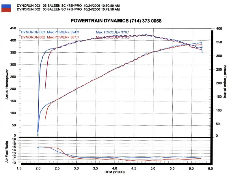

2005-2006 S281 SC's make the advertised 435 HP however they peg the MAF at 5k RPMs and the A/F ratio shoots to 13.5+
The 475 HP upgrade kit on my car produces 465 HP at the crank but at least the A/F ratio is spot on.
Amazing.
435 HP SC car
My car with 475 HP upgrade kit

Wish I had known you were going there. I work a couple blocks away and would have liked to have seen your car on the dyno. I also would have suggested that you get the SAE graph instead of “Actual Horsepower”.
Yeah Steve kind of laughed at the SAE idea right off the bat :shrug:. I guess it is probably pretty close. Who knows, maybe that plus my wheel imbalance can account for a bit of this power that is "missing".
I ran the correction factors this morning based on a few assumptions about the weather yesterday and it wasn't that big of a change. Temps were in the low/mid 70's so that factor is pretty much 1. The one that is probably more variable though is the air density.

Saleen is offering me to have them look at the car to see if there's any reason the numbers didn't come out right. I figure at this point I've spent enough time diddling with my car it is now time to just enjoy it and forget being anal.
Ok at the time of my dyno it was 73 F and 29.92" Hg in Huntington Beach. This gives me lower HP numbers SAE. If you assume higher temps you'd have to go to 120 F. If you rather assume lower pressure you'd have to be at the equivalent of 1,000 ft elevation for those conditions.
