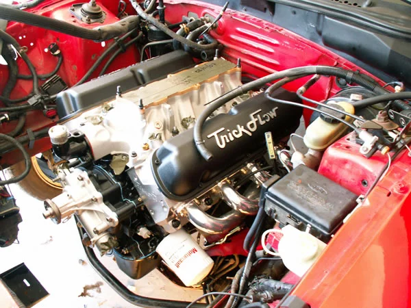

ahh ok... makes sense. Hey, Gcom, is that a 331 with the trick flows on it? It looks verÉ nyce
Sure is: http://forums.stangnet.com/showthread.php?t=688786
I'm almost ready to fire this puppy up.
