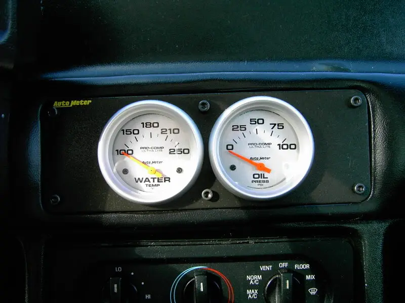

jaswir, what did you use for the autometr gauges?
Jaswir
Mar 31, 2005
578
18
Orlando, FL
Mar 31, 2008
#20
  • Mar 31, 2008
  • #20
same kind of bulb as i used for the dash
