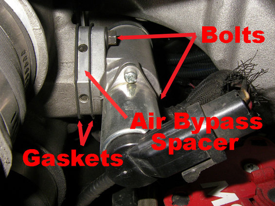

2) There is am idle valve control spacer with Allen wrench adjustments right after the IAC, like this one on the link below.
http://www.supermotors.net/getfile/912900/fullsize/iac-(32a).jpg
3) While the IAC was totally blocked off, for the past several years, the engine would rev fast and come back down very fast, but stall, not idle, or idle with the AC running, always.
4) Yesterday, after installing the new IAC -- Duralast / Wells part number TV206, it idles great, but the engine does not slow down after pressing in the clutch, while shifting for about 3 seconds. It actually speeds up a little, instead of dropping rpms.
Big Question: I replaced the new IAC exactly like the old one. Could it be upside down? The way that mine is installed, the electrical connector comes in on the top. This is the way I installed it, like it was!
Here is a photo: In this photo of another car it is upside down from mine, and the wiring connects from the bottom!
http://www.stang.cc/tmcagallery/d/23598-1/iac.jpg
Is mine upside down?
Also, should I delete the idle valve control spacer, with the Allen wrench idle adjustments?

I think toyman has given you some pretty good advice. I would do that first. He seems to be a pretty smart guy ( even if he is from Canada )
Your car has that many mods and no tune? That would probably be your next step.
I have never seen that idle spacer. Very curious little piece. I am sure someone here can give you info on it.
I don't think it matters which way the IAC is facing. It's just a servo that moves a diaphragm in and out right?
Did you clean the TB and all its passages of all the carbon buildup when you had the IAC off?

I cleaned the Mass Airflow Sensor and wiring, throttle body, adjusted the TPS and Idle Speed Screw, returned the new IAC that I purchased to the store and blocked off the IAC, like it was before, ( for the past several years ) Goofed around with the Idle Air Adjustment Plate ( with the two Allen screws) and Idle Valve Adjust Screw.
It now Idles around 850 and maybe 750 with the A/C running. It never cuts off at stop signs or sudden stops, no hanging RPM’s, and no surging RPM’s at all.
It does not sound as cool as it did when it was idling really slow, with the Harley Davidson type lope, but no more nursing the car and goofing around with the gas pedal when coming to a stop sign!
