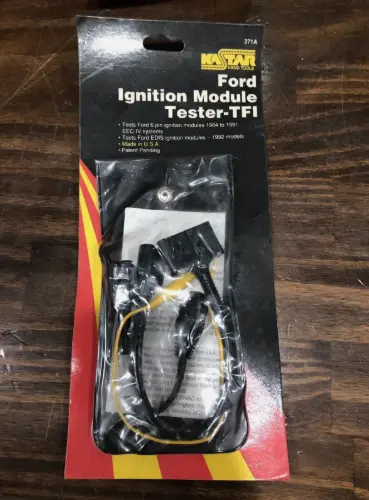

Sounds like it's a faulty TFI module
check your current TFI Module, by buying this off Ebay
https://www.ebay.ca/itm/26737177741...pid=5335821607&customid=&toolid=10001&mkevt=1
It comes with instructions on how to use.
And don't forget to buy a 9 Volt Battery.
