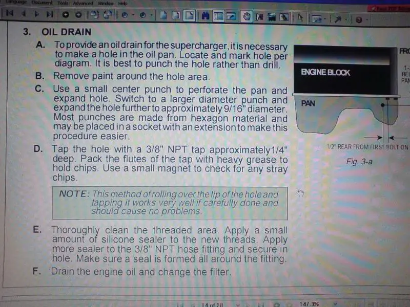

pretty easy
Per Vortech's instructions- this is for the bung that comes with a vortech kit
http://www.vortechsuperchargers.com/pdf/manuals/4FA218im.pdf
Done.
That is what the car mags do, just like the directions. I would worry about metal chips in the pan, but Vortec would not want your motor blowing chunks before you over boost it.
