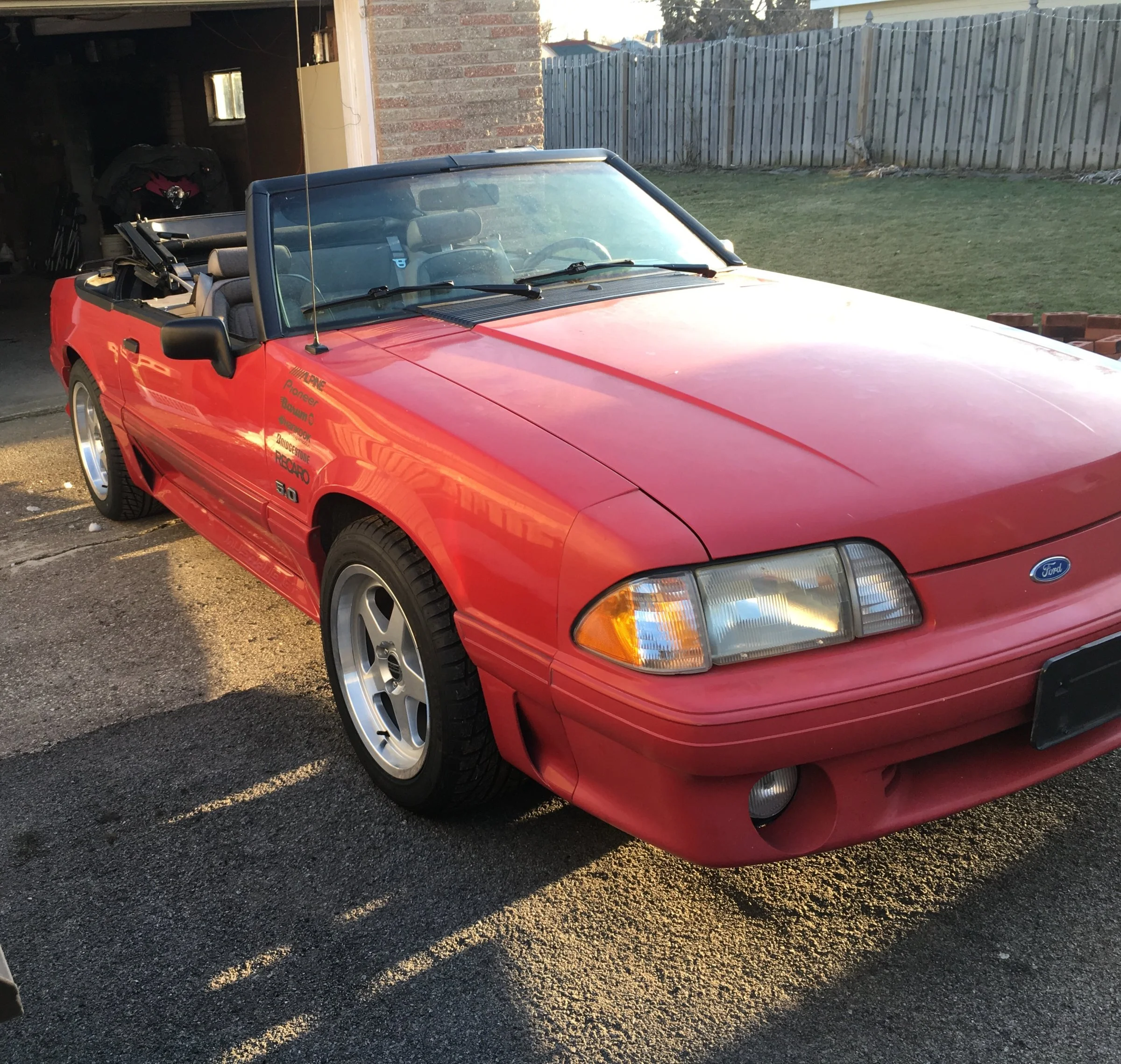

I have a 1990 GT convertible and the idle was surging after a few minutes of running so I did some research and replaced the IAC valve and when I started the car it ran great for about 10 minutes then it started to surge again so I replaced the TPS sensor as well and adjusted it to about .96 and once again it ran perfect right from the start up and did for about 15 minutes then when the car was warmed up it started surging little by little till the point where it drops so low it stalls idk what else it could be any help??
