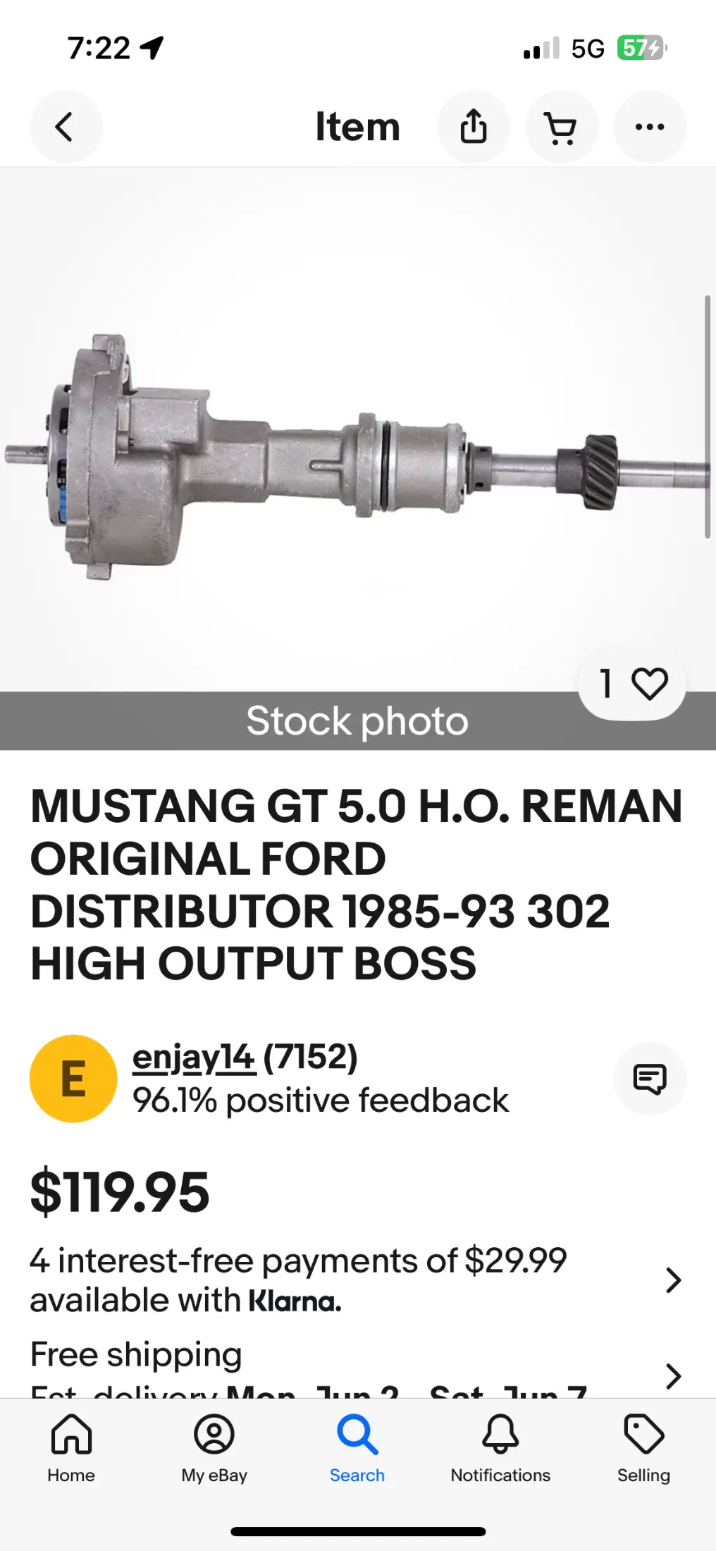

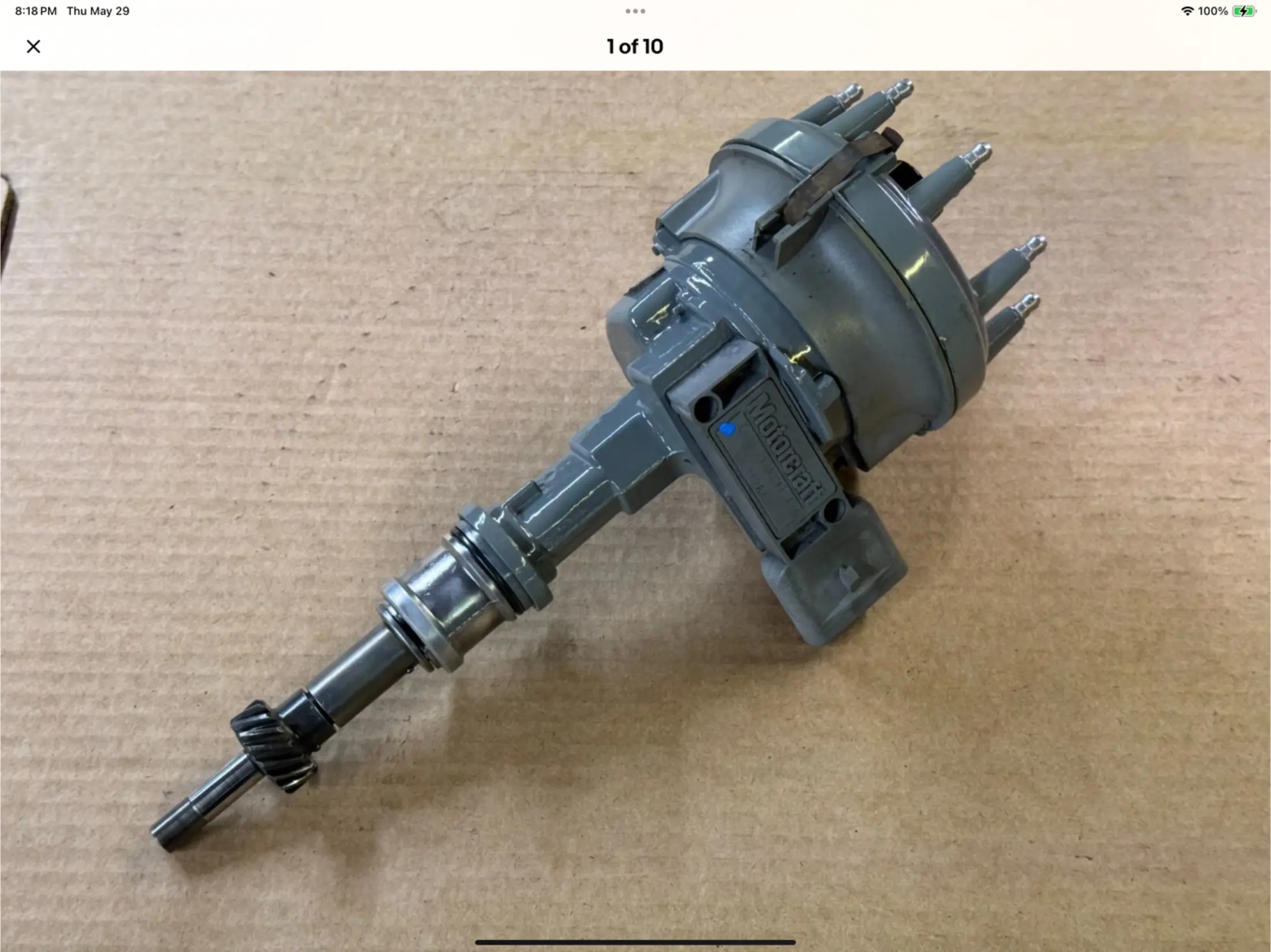

So what do you think about these remanufactured ones on eBay?

I have not tried that specifically. All I can say is that if I were looking for one right now, I would probably give it a shot.
Even if it shows up bad... You can still replace the faulty parts.
Just be sure that it has the [steel] gear on it for your roller 302.
Also....
That does not appear to have the TFI on it. So, you're going to need some thermal paste.
Also... I think you currently have two TFI, is that correct? If either of them are OEM, that is the one I would use. Otherwise... doesn't matter.
