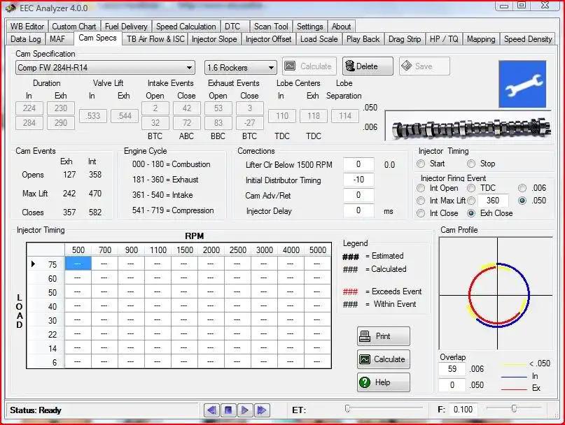

Does anyone know of a calculator that will calculate injector timing from cam specs. I have Compcam XE276HR.

EEC Analyzer will if you also have a datalog. It does not have your cam pre loaded, but you can manually enter the info.

Yes I have EA - but am no longer using Ford EECIV & Tweecer.
I am using MOTEC M800.
Am chasing a theoretical table.

injector timing needs to be tuned for the specific car IMO. AS injector size plays a HUGE role in the injector timing.
