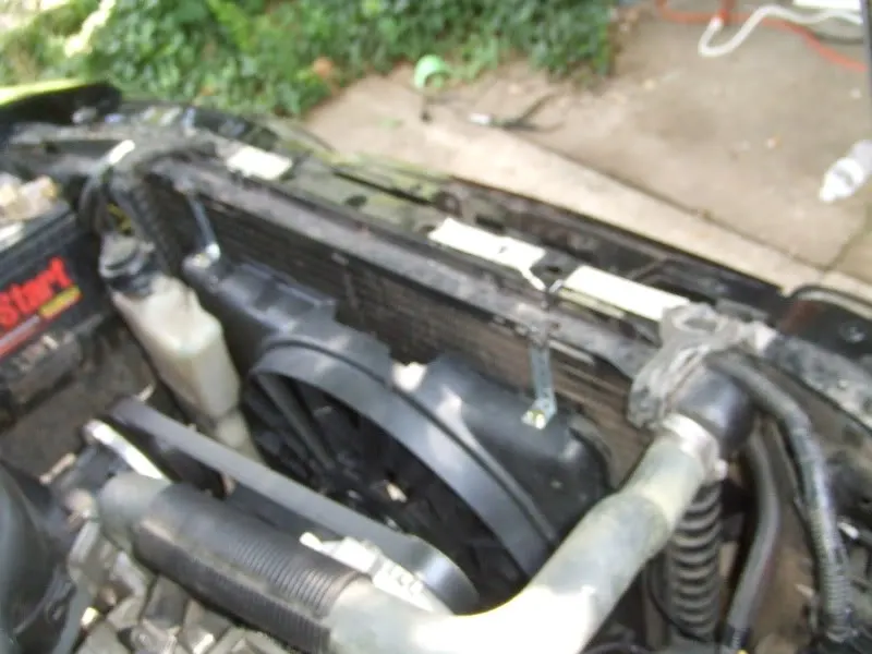

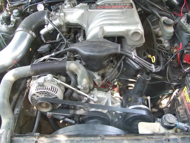

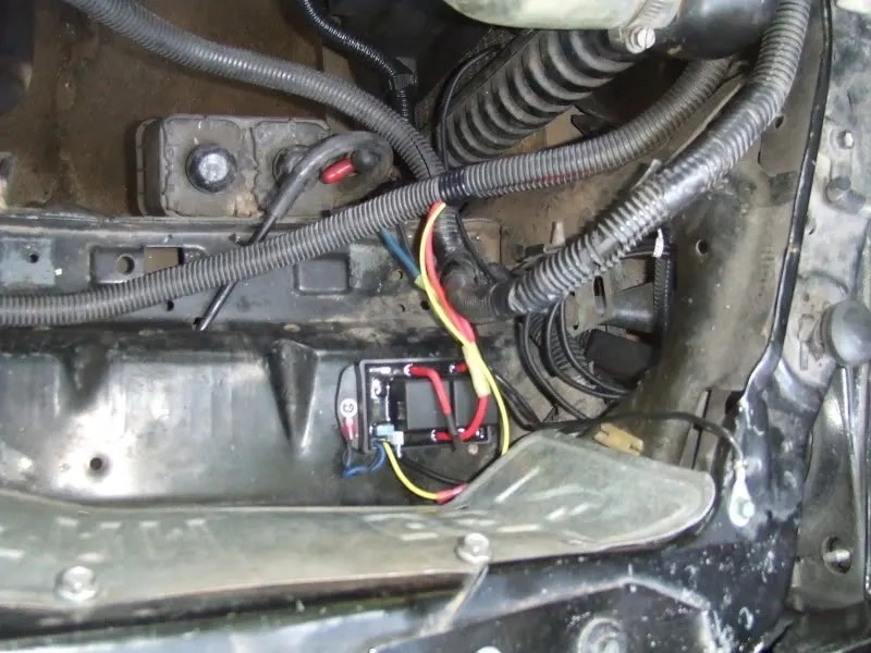

finally got around to installing my taurus fan and DC controller. pretty straight forward, the install went smoothly.
here's the controller...ignore the license plate ...it's temporary until i get some sheet metal to fab up a cover for the airbox hole.
please excuse the dirtiness and all the wiring, i plan on putting loom on the wires going up to the controller and the loose red wire on the driver's side i plan on hiding in the fender with the rest of the wires already hidden...just gotta find time to pull the fender to do it.
let me know what you guys think.

How does the controller work? Where does it take a temp reading from?
I'm curious because my Flex-a-Lite just has a thermocouple that sticks into the radiator.

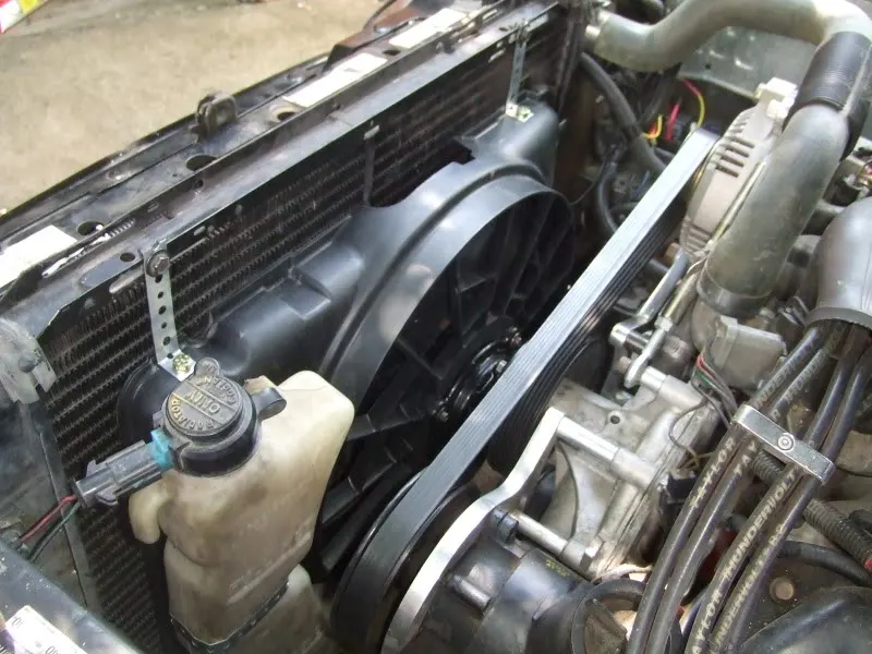

it has a probe that you stick into the radiator as well. if you look at the last pic, you can see a black wire going into the radiator...that's the probe.
as far as how it works, it comes on at 185* but is adjustable via a potentiometer. it has hook ups to work 2 speed fans, but i don't have a/c, so i just have the high speed connection hooked up.

that metal straping gonna hold it when it kicks on? that's pretty weak stuff
yeah it seems to be okay so far. i plan on moving the fan up on the radiator which will make the straps shorter/more sturdy so the strapping should be okay.

Do you not want the temp probe near the radiator outlet (bottom, driver's side)? The older units were calibrated for this location to be used.
I agree with using heavier metal for the straps. Muffler strap is ok for mock-up/templating, but you'll want more. That strap breaks apart pretty easy (repeated flexing causes it to break). And as noted, the motor creates a lot of rotational torque. If you have a vice and a hammer, you can bend some aluminum brackets up pretty easy in a minute or two. The muffler strap templates will make it real easy to do.
i'm not sure where the best place for the probe is. i just went by the install instructions DC gave me. it says (not verbatim) "on a cross flow radiator (where the tanks are on the sides) place the probe on the upper hose side, about half way between the top and bottom."
i'll take your guys' word for it and change out the strapping for sturdier braces. i drove my car across town today and the fan never turned on, so i haven't seen how the strapping holds up to the fan's torque yet. im 99% sure i have it wired up correctly, wiring isn't complicated, but i need to double check over everything. like a 'tard, i turned the potentiometer knob when i first got the controller in, just cause i wanted to fidget with it, so i don't know if i messed up the setting. i'll have to tinker with it sometime in the next few days when it's not pouring rain.

There are these awesome straps at autozone that are like an oversized zip tie. They work perfectly for holding a fan on and it's like 8 bucks. I'd go that route... Wait I did!

I'm pretty sure he still has the probe at the radiator outlet. I just looked up the instructions for a FK50 and that's where he has it (as it was on the FK35). The unit is calibrated for the temp drop across the coil (after after the area the fan has cooled).
I would be careful with the pull-through ties for mouning a fan to a radiator. The fan creates a lot of torque and can tear a nice hole in the radiator. Mounting brackets are better IMHO.

buy yourself some thicker 1" wide or similar aluminum strips from Lowes or Home Depot. Easy to bend with a vise and simple to drill. Might cost you 10-15 bucks but will look nicer than strapping

The problem isn't them pulling through the radiator. The repeated on/off torque from the fan can allow them to hog a hole (radially) through the radiator.

well i took her out and actually let her warm up and the fan/controller works perfectly. i have it adjusted to come on at about 180-185 ish, i didn't have an infrared thermometer handy.
as far as the straps, the fan didn't move a wink when it turned on. the DC controller slowly ramps up the fan's speed so it doesn't hit with a bunch of torque. i'm still probably going to change them out though, something that looks better at least.
